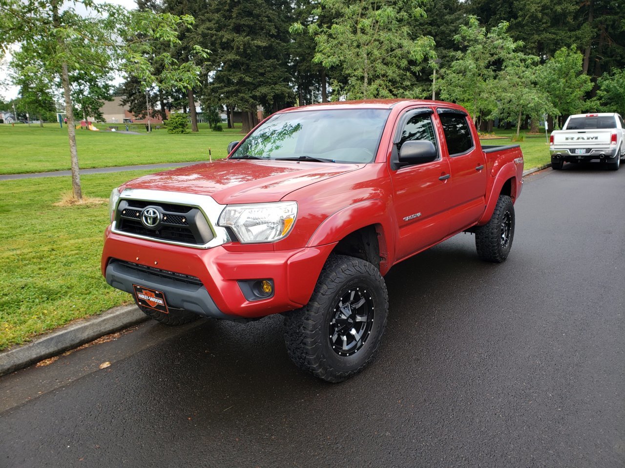

    Eibach Pro Stage 1 on 2nd clip, 3 leaf Icon AAL's in back.
    I removed the old Rough Country 3 inch leveling kit. 3 inch spacer in front 2 inch in rear along with rear shocks. Can be had for $300 new.
    Installed Eibach Pro Stage 1 on second notch along with Icon 3 leaf AAL and left the overload spring in.

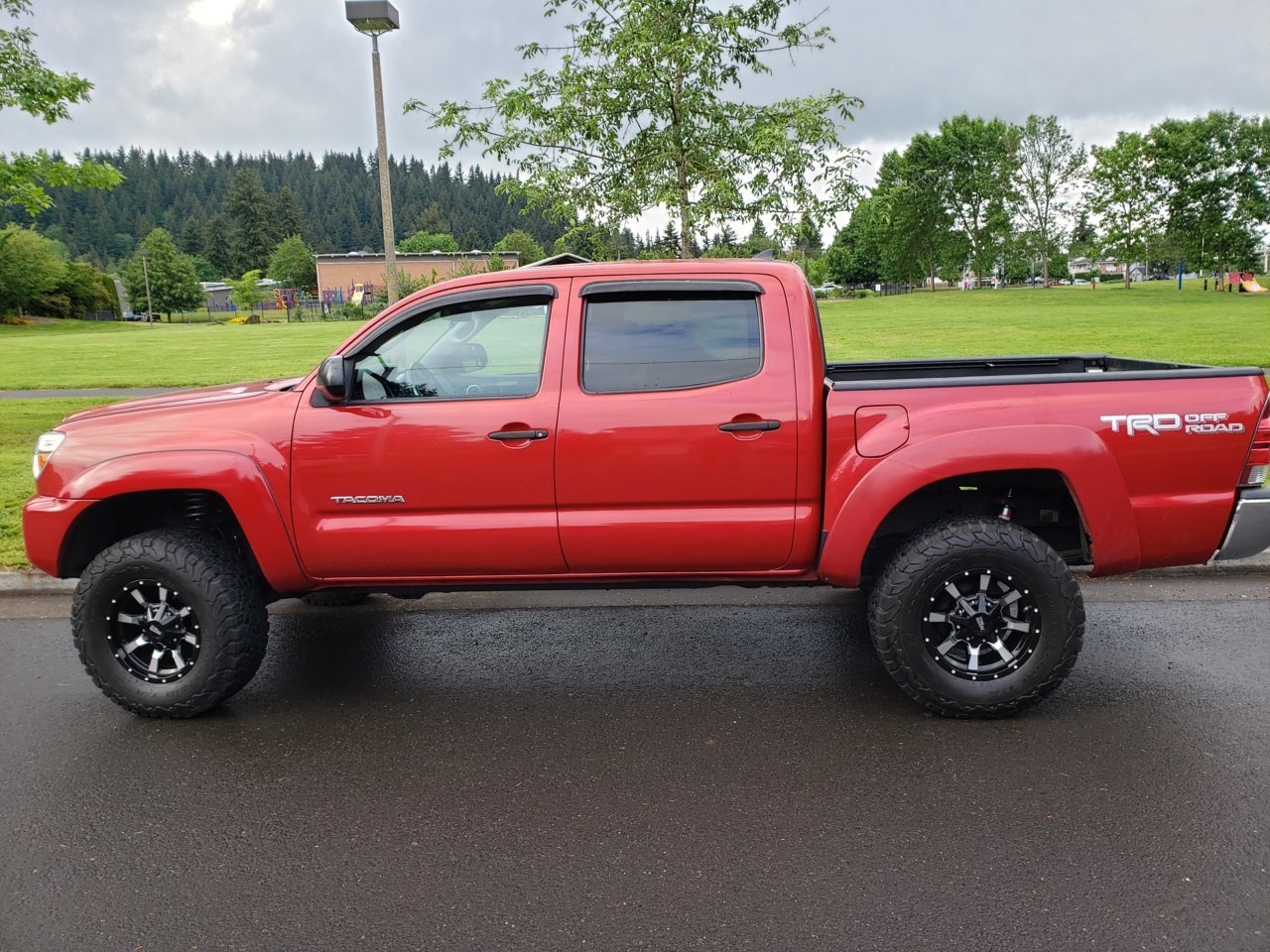

    Net result in lift on truck measured from center hub to fender lip.
    Before - After
    LF 22.5 - LF 23
    RF 22.75 - RF 23.25
    LR 23 - LR 23
    RR 24 - RR 24
    So you can see it basically gained 1/2 inch up front. Sits about as level as it can get without a shim.

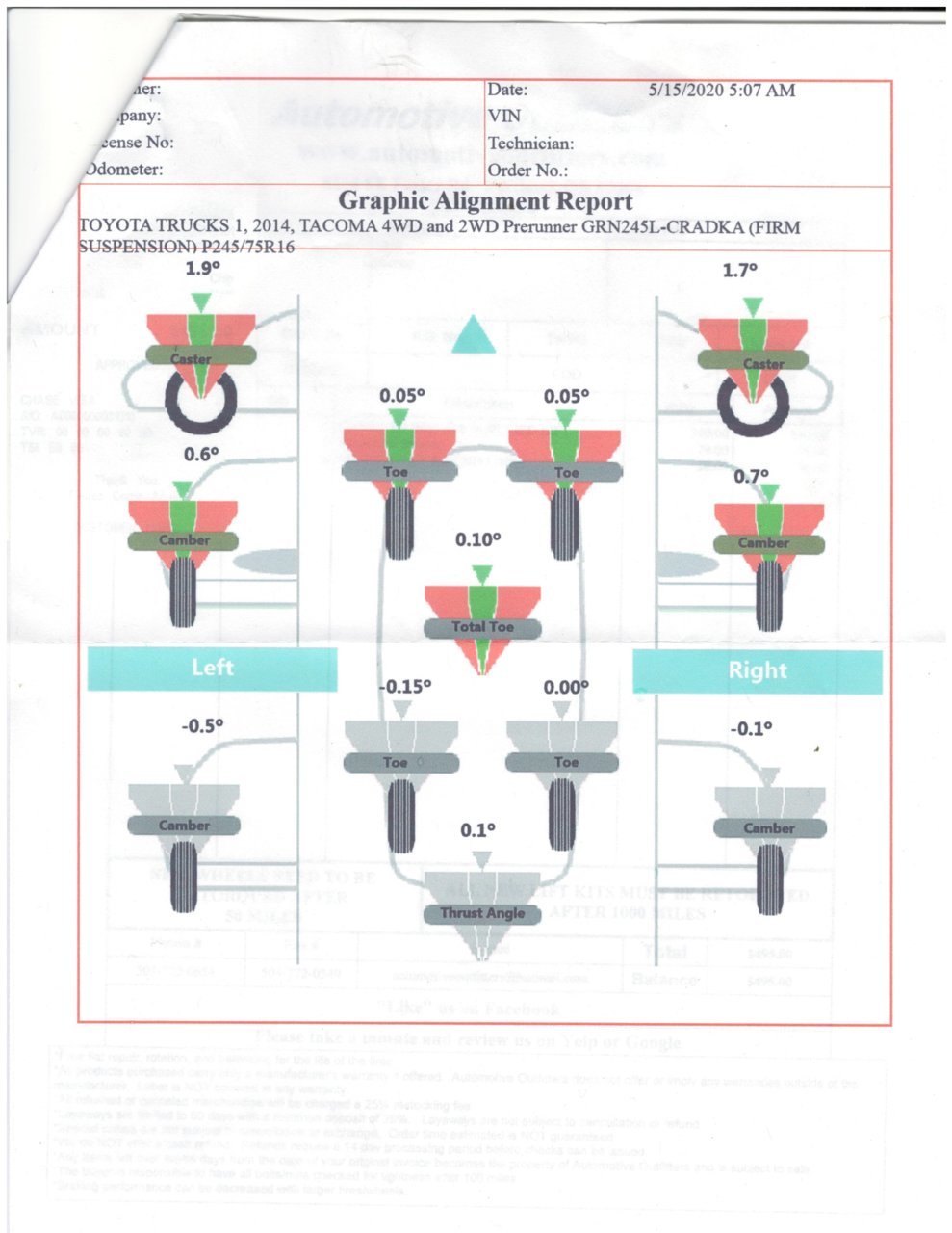

    Install $340, alignment $79 done by Automotive Outfitters in Portland Oregon.

    Here is the alignment and final pic.
