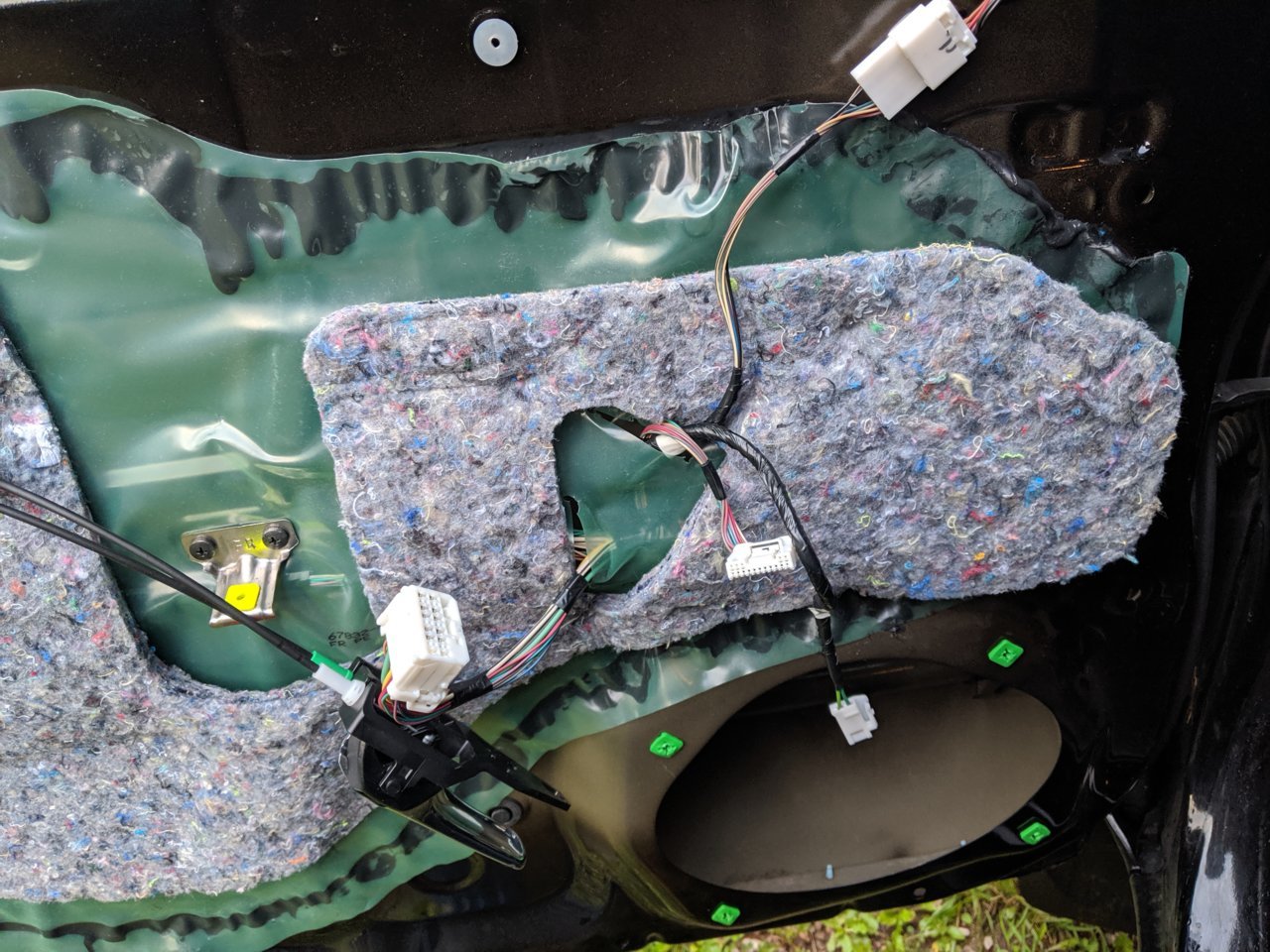

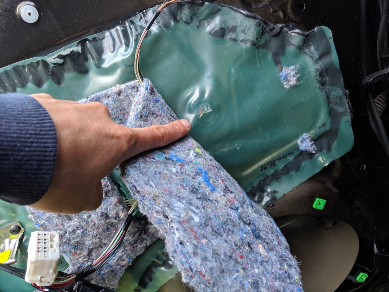

    So I figured out what it was. The connector to the window motor got disconnected. Really weird because I would've had to remove the plastic and cloth deadening material to get to it, which I did not.
    I'll post pics when I get better signal.

    A connector that has no reason to be touched during speaker installation. I'm more than willing to take full responsibility for this dumbassery however I feel it came loose from the factory. It was completely disconnected and when I connected it it snapped back into place perfectly.
    Oh well... I can honestly say that now I'm really good at removing and installing door panels LOL
