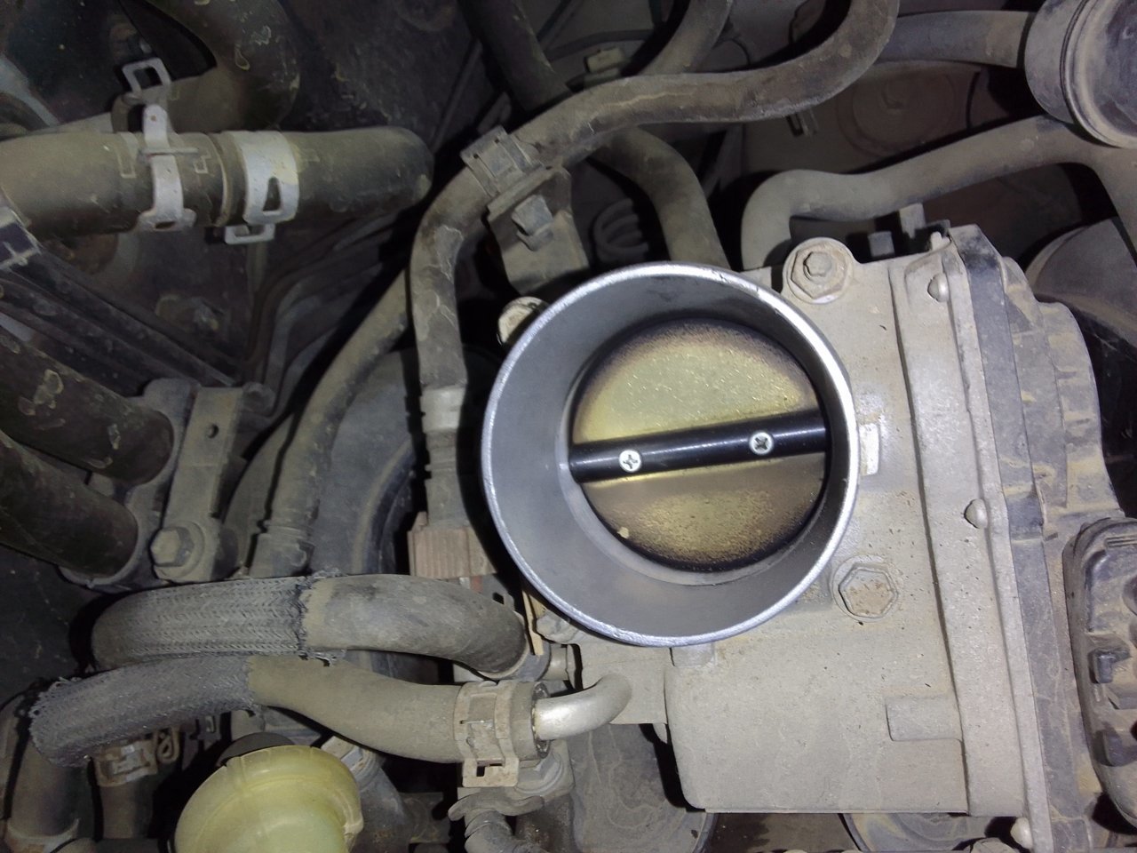

    I actually made a pic of the butterfly valve as I thought it was pretty dirty. I will see if I find the time to clean it.

    Yes that is dirty...

    Thanks guys. I cleaned it and the problem is fixed. It ran rough after the first start as it needed to get rid of the junk which came off the butterfly valve
    and dripped in the manifold. But 2nd start it ran like it supposed to do. Happy days.
