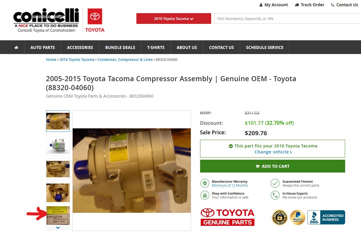

    tak1313
    tak1313 Well-Known Member
    Aug 24, 2020
    #338673
    717
    2013 Base 2WD
  15. Jun 28, 2022 at 4:56 AM
    #35
    71RAT
    71RAT [OP] Active Member
    Jan 5, 2019
    #278173
    35
    2010 Tacoma Access Cab TRD Offf Road Silver
    2" lift
    So is everyone finding they have the Denso compressor? That would make me possibly go with the Delphi? If it's a direct fit. I'm having the one of the shop's I do transmissions and dif work for, do the charge and flush, if needed. I don't even have a set of gauges any more, probably wouldn't remember any way.
  16. Jun 28, 2022 at 6:11 AM
    #36
    tak1313
    Aug 24, 2020
    #338673
    717
    2013 Base 2WD
    I THINK the Delphi and Denso is the same compressor. Even if you look at the Conicelli page I linked above, in one of the close-ups, you can clearly see the Delphi sticker on it. I BELIEVE Delphi is primarily a marketer/distributor now rather than a full on manufacturer since Borg Warner bought the entity out.
