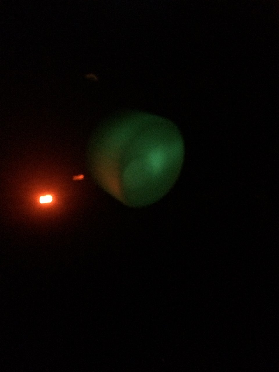

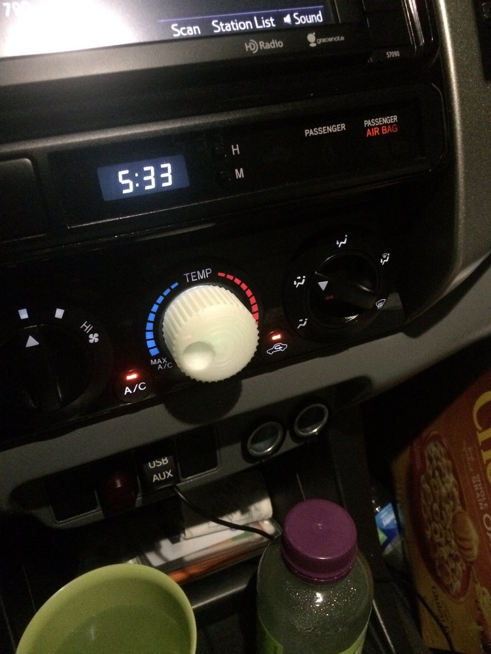

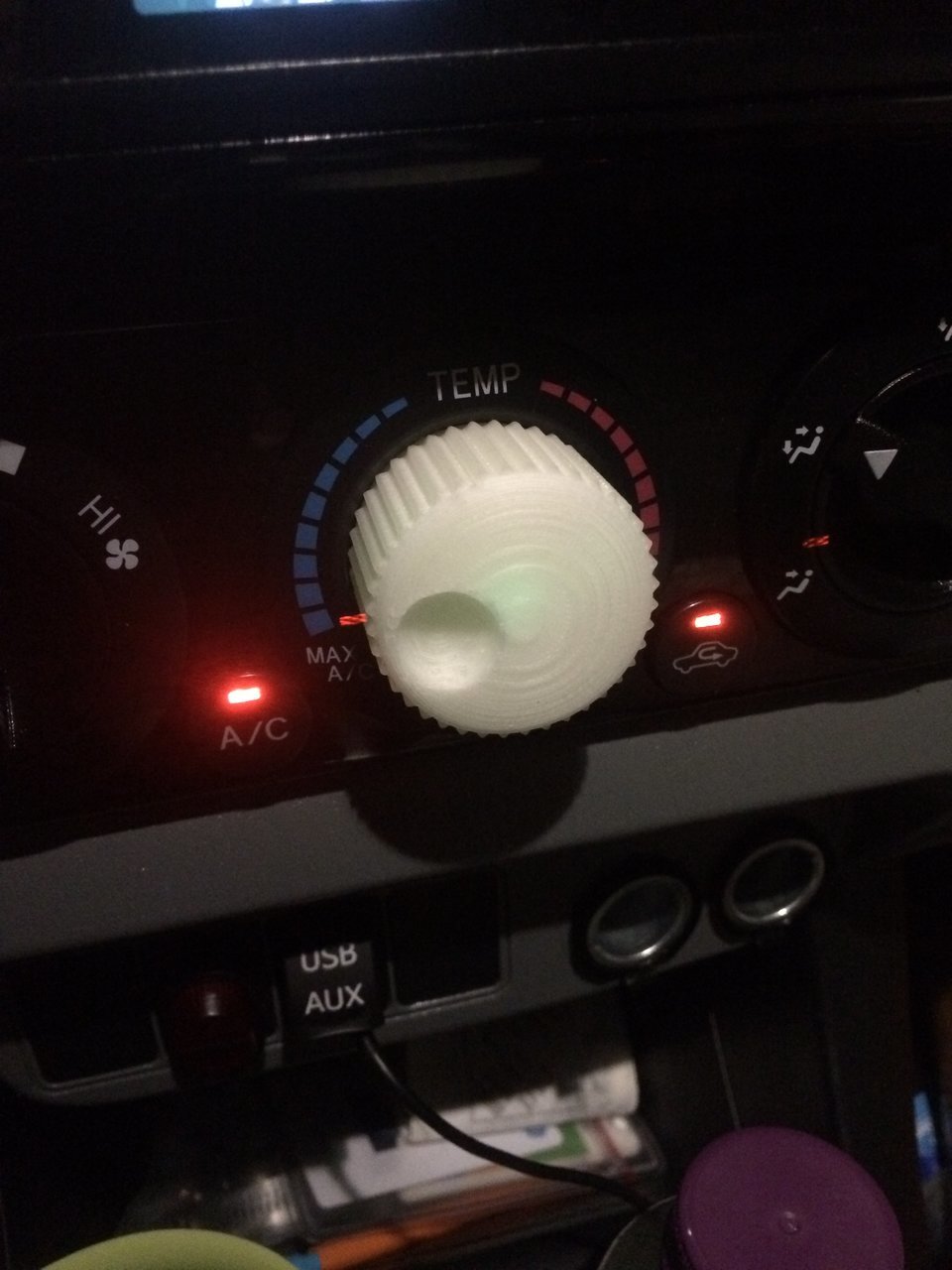

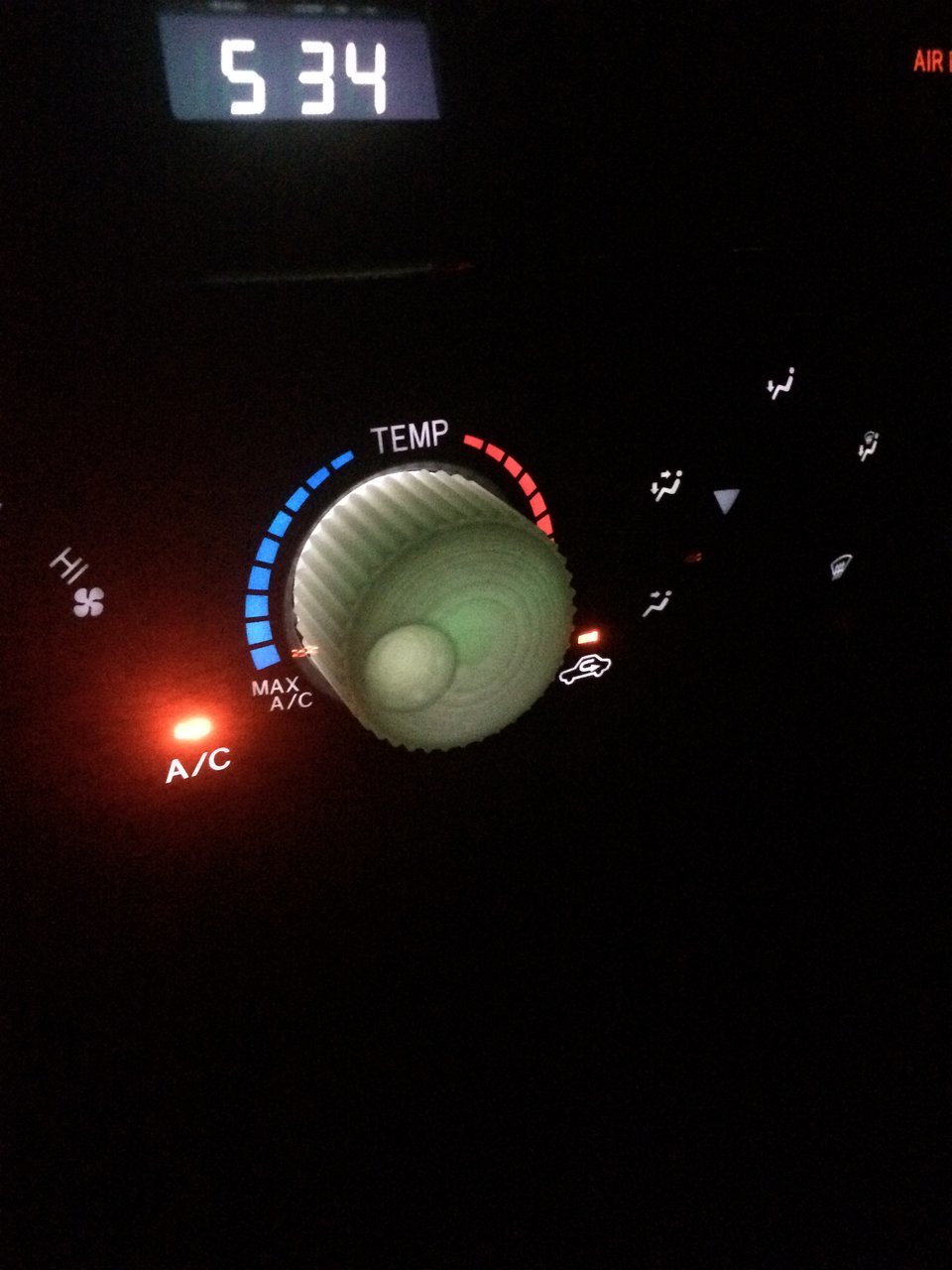

    Plastic knobs were cracking so wanted to make new ones that were bigger and tougher. Designed with knob configurator on thingiverse & Used glow in the dark PLA material.

    I just found a cracked knob about two weeks ago, and mine have always been handled gently. I super glued it back together.
    I like the idea, but why is the indicator hole so huge and clunky? Why not an arrow or smaller hole? I assume these could be used in all three positions right? These look much more glove friendly. I like the glow material too, nice job! Thank you for sharing Steve!

    The hole is an easy change. This is just the first prototype so its good feedback. I wasn't sure how much the backlight would shine through the material so i made it large for visibility. I think it could be smaller.

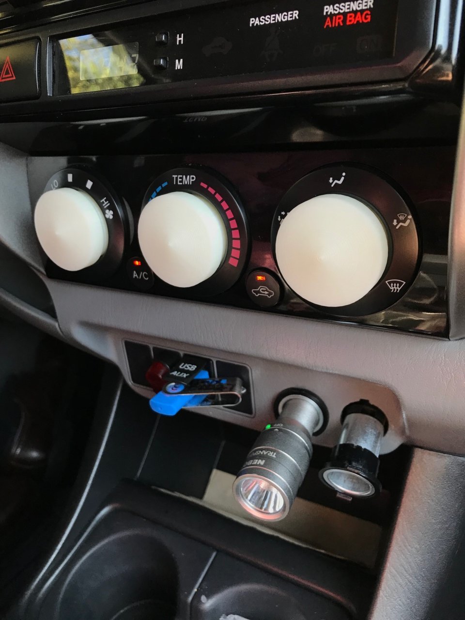

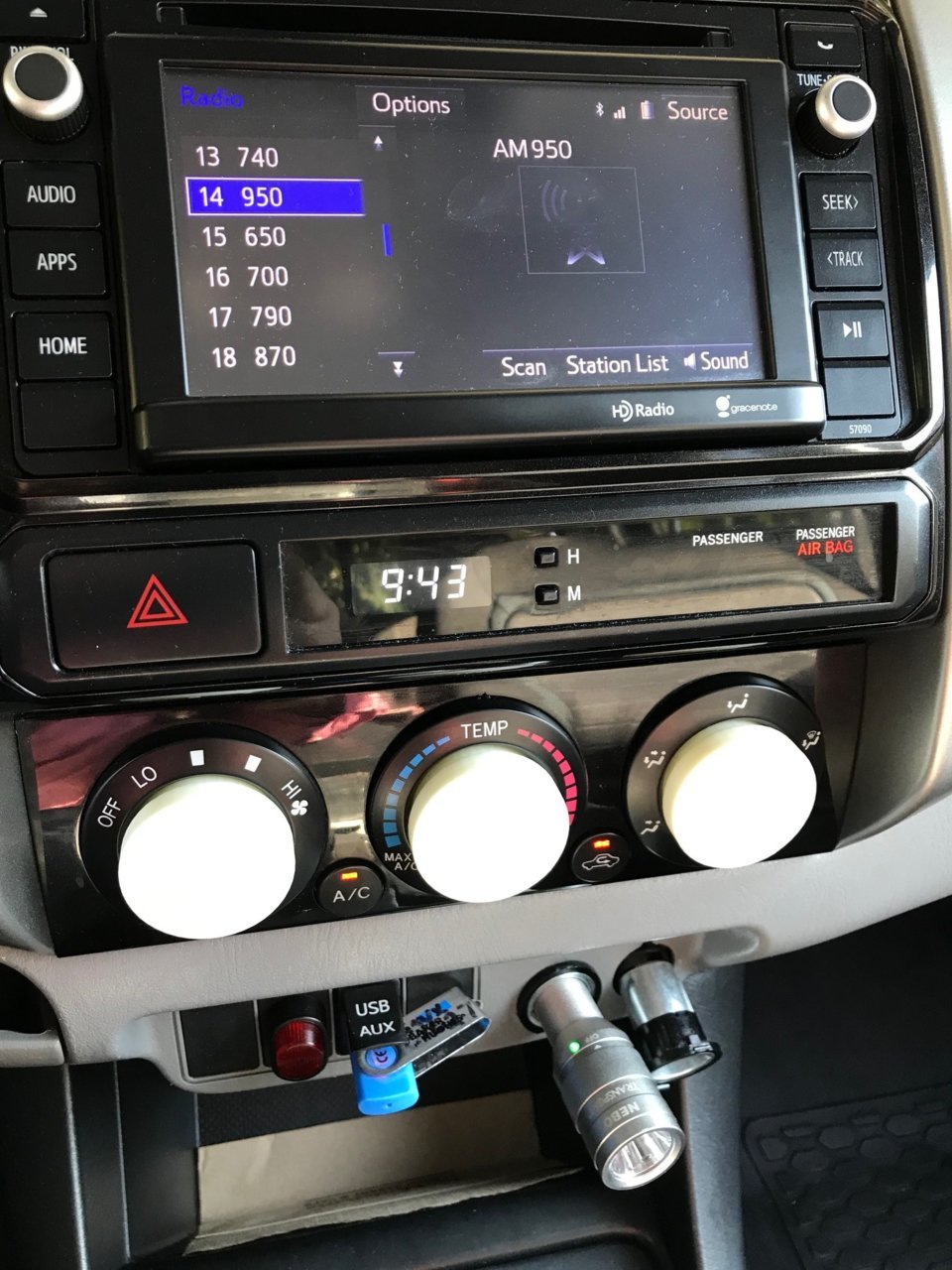

    Hi all,
    I rebooted this project when I got my new 3d printer and finally found a source for knob springs. Upgraded to luminescent ABS as well and these are the first results. Very good fit. Assuming the "hot truck" test succeeds, it should be all aesthetics from here. Thanks for all your input!

    Thanks! Not yet but I should post it soon. The springs were the biggest problem as I could not find them anywhere for a long time. I finally found a supplier but had to buy qty 1000 minimum & I had to order using a purchase order through email. At this point, I am just in it for the love of the project! They are a little stiffer than the OEM springs but work well.
    Lectra Products Part# 1800 Hi Torque Springs
    http://www.lectra-fasteners.com/hightrq.htm
    I know, I know. It isn't really logical other than I enjoy it. Plus I am learning how to use Freecad modelling and how to use my 3d printer. I might want to do some customization as well; something like embedded logos or unique geometries.
