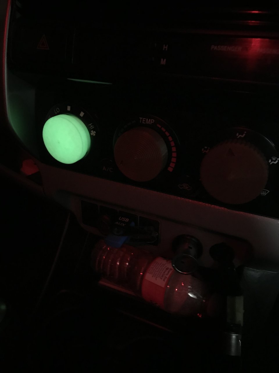

    Thanks for the responses guys. The material actually takes quite a lot of light to glow bright green. Driving into a parking garage on a sunny day would probably make a good display but I have not noticed the luminescence much during night driving as the led behind the know isn't too bright. It does still look cool though since the material is semi-transparent. The resolution was .18 mm per layer. One the originals it was .3 mm per layer. Thats why the new ones look smoother. The finished version will be shiny as well since i have build an acetone vapor chamber (see link below). I print most prototypes in coarse resolution to save time and I print a lot in other-than-glow-in-the-dark plastics since the luminous material is abrasive for the nozzle. I actually do have an arrow worked into the design already. On the masking off the edges - I am working on dual plastic prints as my printer has two nozzles - just haven't tried it yet. I figured that something to break the "white" monotony would look better as well. Good feedback, encouragement, & critiquing guys. much appreciated!

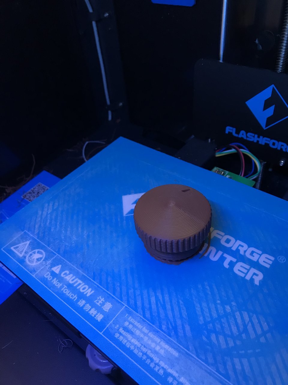

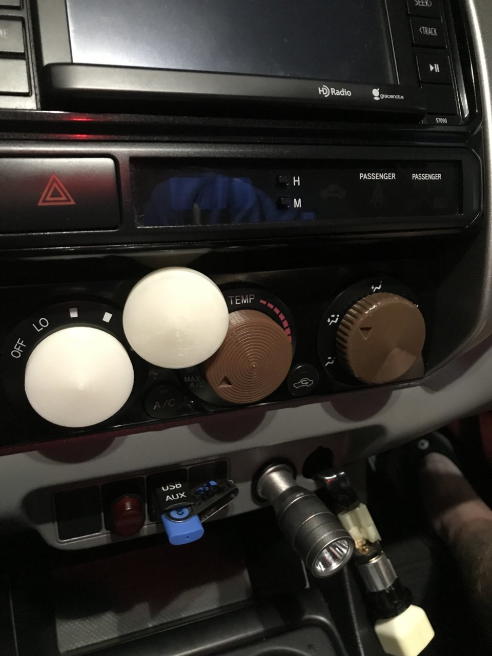

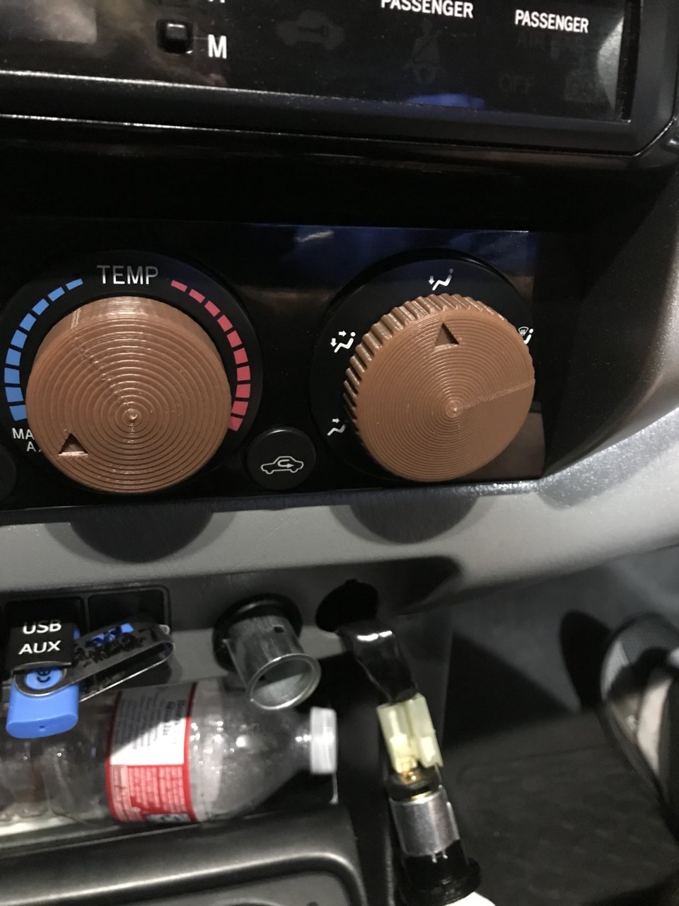

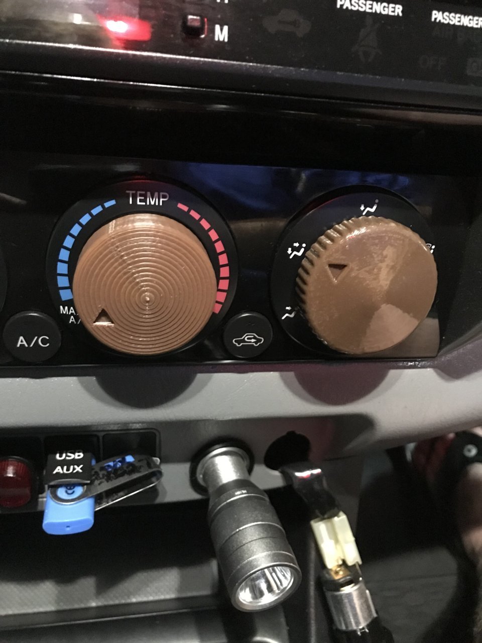

    Got the new model printed - chose brown since it really was only a test fit and to see how the color matches the interior.
    Low res left on older model, higher res right - has indicator and ridges on OD - before vapor smoothing.
    After smoothing
    Added a glow in the dark smoothed knob - harder to see the finish in the picture but it came out nice.
    Charged one of knobs with a flashlight...

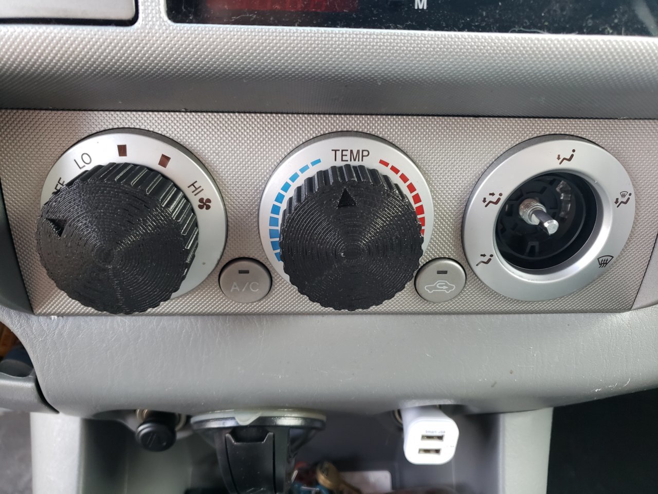

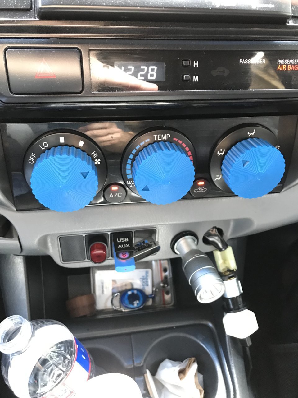

    Redesigned. Thought they were too small before. These feel really good.

    Here are the knobs
    TRDSport10 and Garfish307[OP] like this.

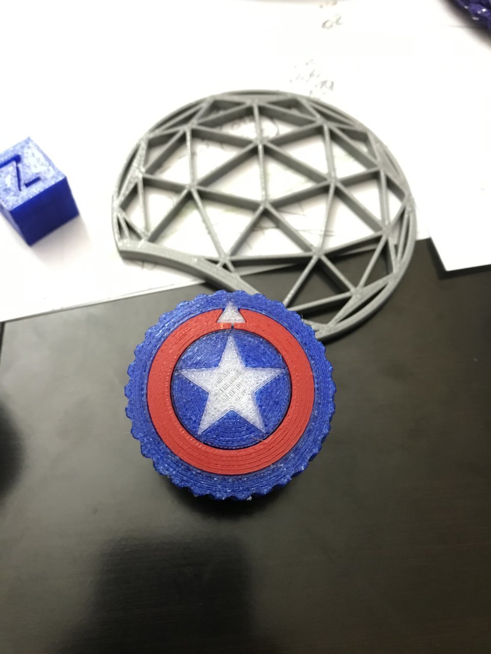

    Here is the new prototype with some “creative touches”.
    orezona[QUOTED] and CaptAmerica like this.

    Everyone and their mom already knows about the "chinese HVAC control knob mod". That's been covered in this thread, actually.
    https://www.tacomaworld.com/threads/climate-control-knob-upgrade.471645/ 44 pages worth of commentary.
    What OP is doing is something completely different, has the potential for much more customization and honestly is pretty cool since this is the first time someone has created 3D printed HVAC knobs.
