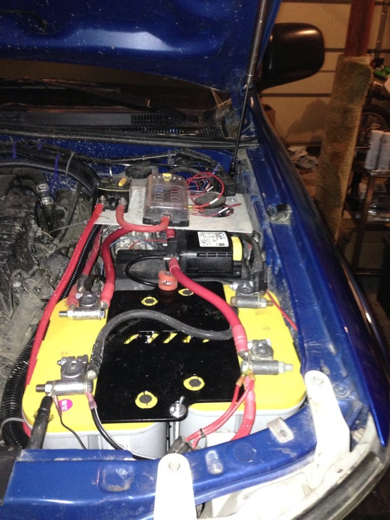

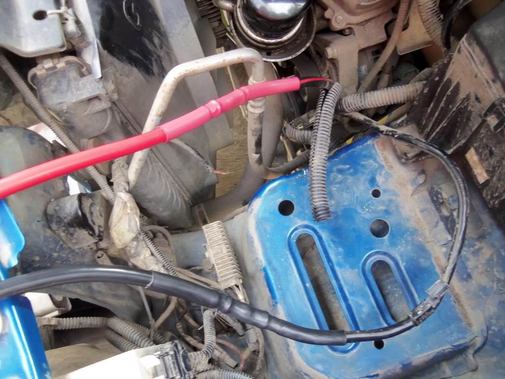

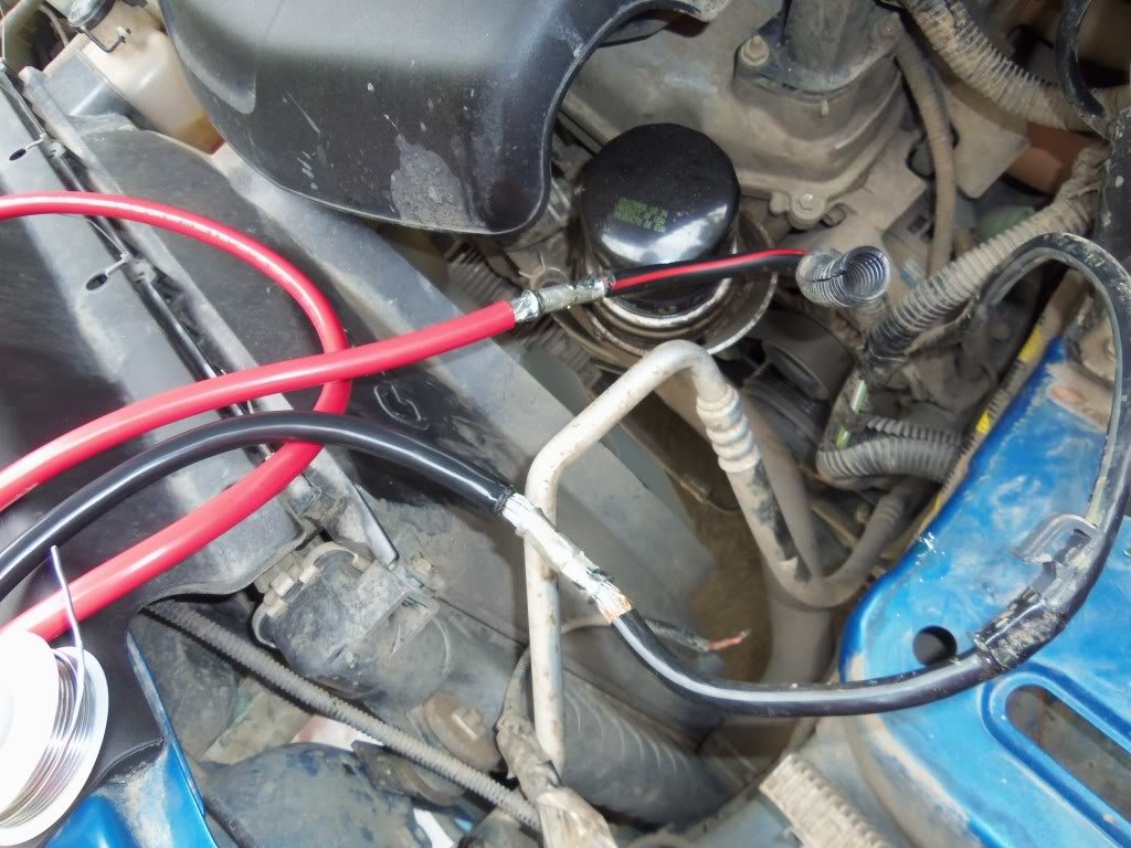

    Got the measurements today.
    These lengths are for the OEM battery wiring and are measured from end to end OF THE TERMINALS, not the actual wire itself.
    Positive Cable (to starter): 37" 4GA
    Positive Cable (battery to fuse box): ~15" 4GA
    Positive Cable (alternator to fuse box) ~20" 4GA
    Negative Cable (to transmission housing): 54.5" 4GA
    I used the following WIRE lengths for my own harness upgrade.
    Pos to starter: 40" 1GA
    Pos to fuse box: 18" 2GA
    Alternator to fuse box: 20" 2GA
    Neg to trans: 56" 1GA
    Neg to frame: 3.5" 1GA
    Alternator body to frame: 5" 1GA
    And some pictures. Everything was wired with motorsport battery cable, terminated with copper (tinned) lugs, and wrapped with DR-25 motorsport/mil-spec heat shrink. If its worth doing, its worth over-doing.
