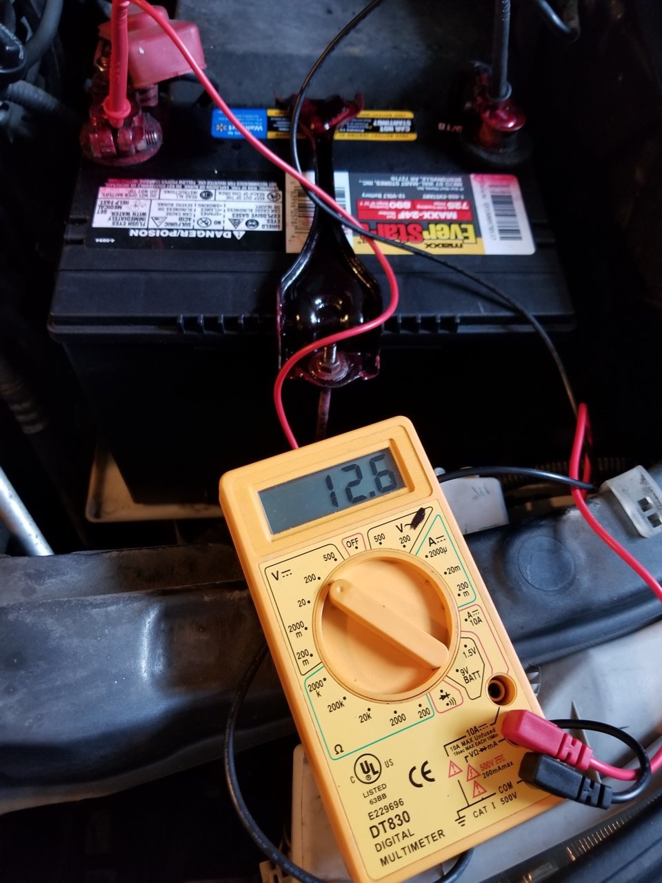

    Brand new battery...

    Some in here aren’t understanding that when it’s running, you’re reading alternator output (~13.6V). When it’s not running, you’re measure battery charge state.

    This is a good point. I assumed that all readings are done while not running.
