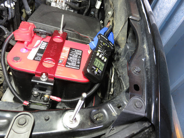

    3JOH22A
    3JOH22A トヨタ純正男娼
    Mar 27, 2019
    #288172
    13,118
    District 6ix
    3G Tacoma on 35"s, 5G 4Runner
    Optima Red Top 35 for 20-lb weight saving:
