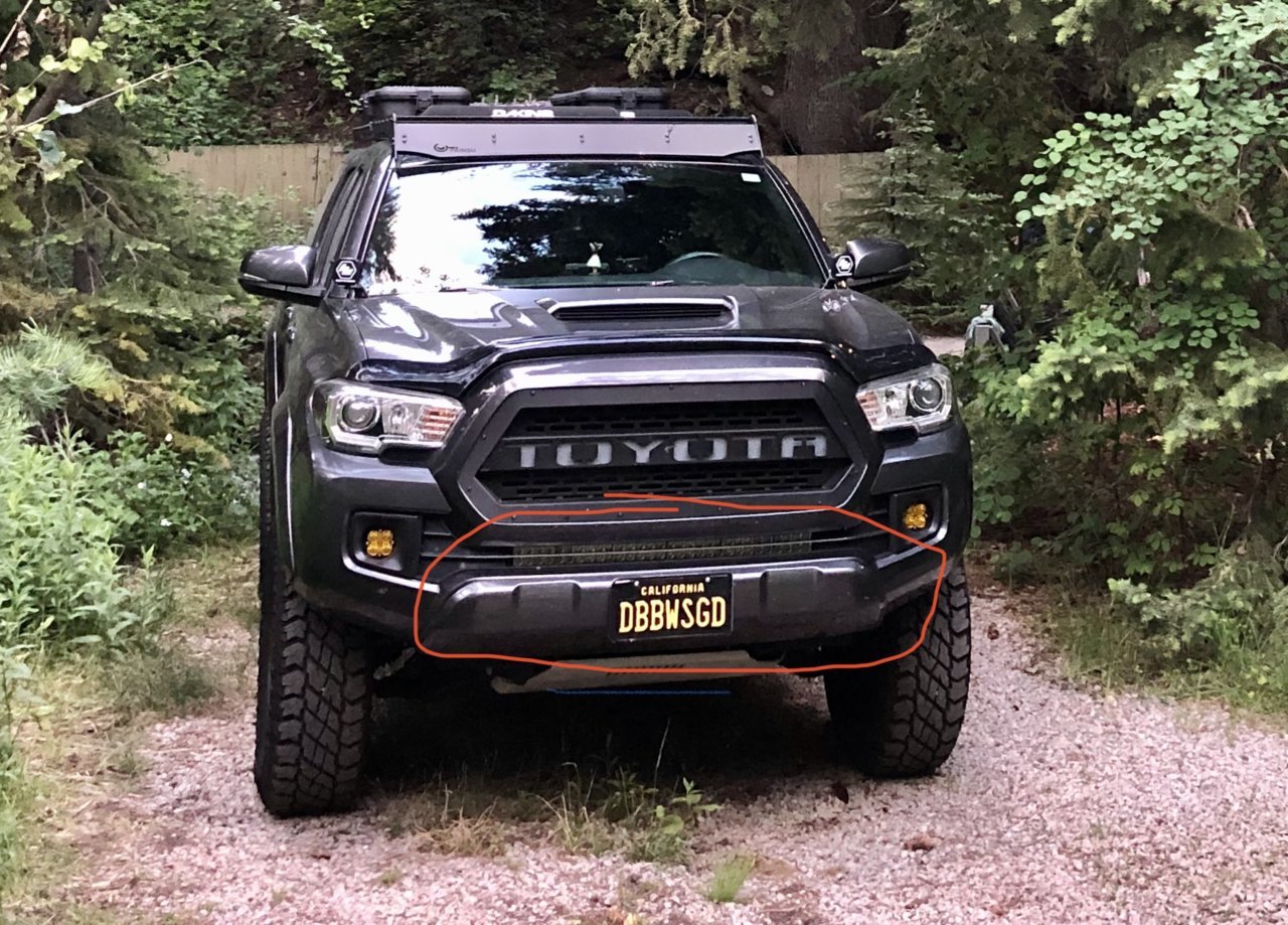

    I recently tapped into something with my front bumper. It didn’t cause any significant damage but apparently broke a few of the clips that hold this piece in place (see photo, below). Anyone know if these clips can be purchased separately? If so, what are the part numbers?
    Thanks in advance.

    They sell clips & push tabs at the Toyota parts Dept.

    There's only two clips that are replaceable that hold this part on the rest are molded into the part. The two that are replaceable are pretty stout vs. the plastic part they go into.

    Over the years on other cars trucks I have used Nylon nuts and bolts or screws FYi

    Busted my clips off recently , found some black selftappers and screwed it on .

    Yeah... I haven’t removed this piece to see whether the clips are broken or the actual mounting points. It currently looks fine but it isn’t held in place solidly and I can move it around a bit. I’m thinking of just using some heavy-duty double sided mounting tape to hold the piece more securely in place. Thoughts?
