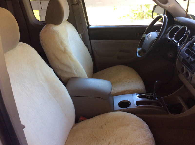

    I put a set of semi-custom sheepskin covers in my '08 SR5. They are not terribly expensive and are supremely comfortable summer or winter. The install will leave your fingers sore, but is doable by most anyone. Many colors are available...I chose natural:

    Man you must be covered in fuzz from those things. Especially when sweaty.

    No fuzz and the lamb's wool doesn't hold odors...standard practice for many pilots, motorcyclists, and truckers.

    Was about to say this. Wool is (surprisingly) comfortable in the summer & winter. Also, if you get a good set, they will have alot of the same properties as merino wool.

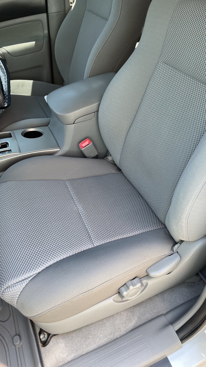

    ^^^ I just ordered this and returned it due to it not matching color or material exactly. Maybe its my ocd but i guess i will have to order OEM

    It is slightly darker than original. But its 11 years old and once its installed you can hardly tell . Plus its a 1/3 the price of oem 2E00FD99-E701-4B3F-AFF1-5E243CFDB695.jpg

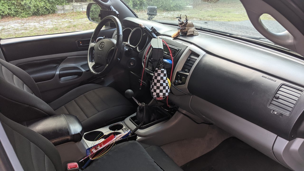

    As for on topic, it's hard to beat Wet Okole's especially if you get in on the bi-annual group buys.
    Way better than stock cloth IMHO, and available in all kinds of various patterns colors and styles.
    I got just some plain black ones with all the hidden pockets.

    I would say yes..... but I would double check. Also the fit is great but i did have to modify the front plastic clip where it snaps onto the seat frame . The front “corners “ need to be cut out. The factory covers has gaps where it connects. This one is continuous all the way. So I used a pair of side cutters and cut away the curved area and then it fits . Otherwise you’ll be fighting it for 30 minutes like i did

    Adding to Tacoma2ndGen. I ordered the seat fabric from eBay and watched the “Tacoma Seat Repair” video on you tube. I replaced all of the hog rings with zip ties including zipping the fabric to the seat foam. I did not snip the curved front piece and it seems ok (I may have to revisit). The black side clips don’t seem to grip well or do much. I replaced the inside yellow clip on the side trim piece with a zip tie.
    The color of the seat fabric looks fine. The fit is pretty good even though my fit is not as tight in the back corners as the post 15 picture above probably due to my mediocre upholstery skill set. Maybe it will settle in better after some use. My Taco is a stock 2006 with 206k miles. I am pleased with the repair.
