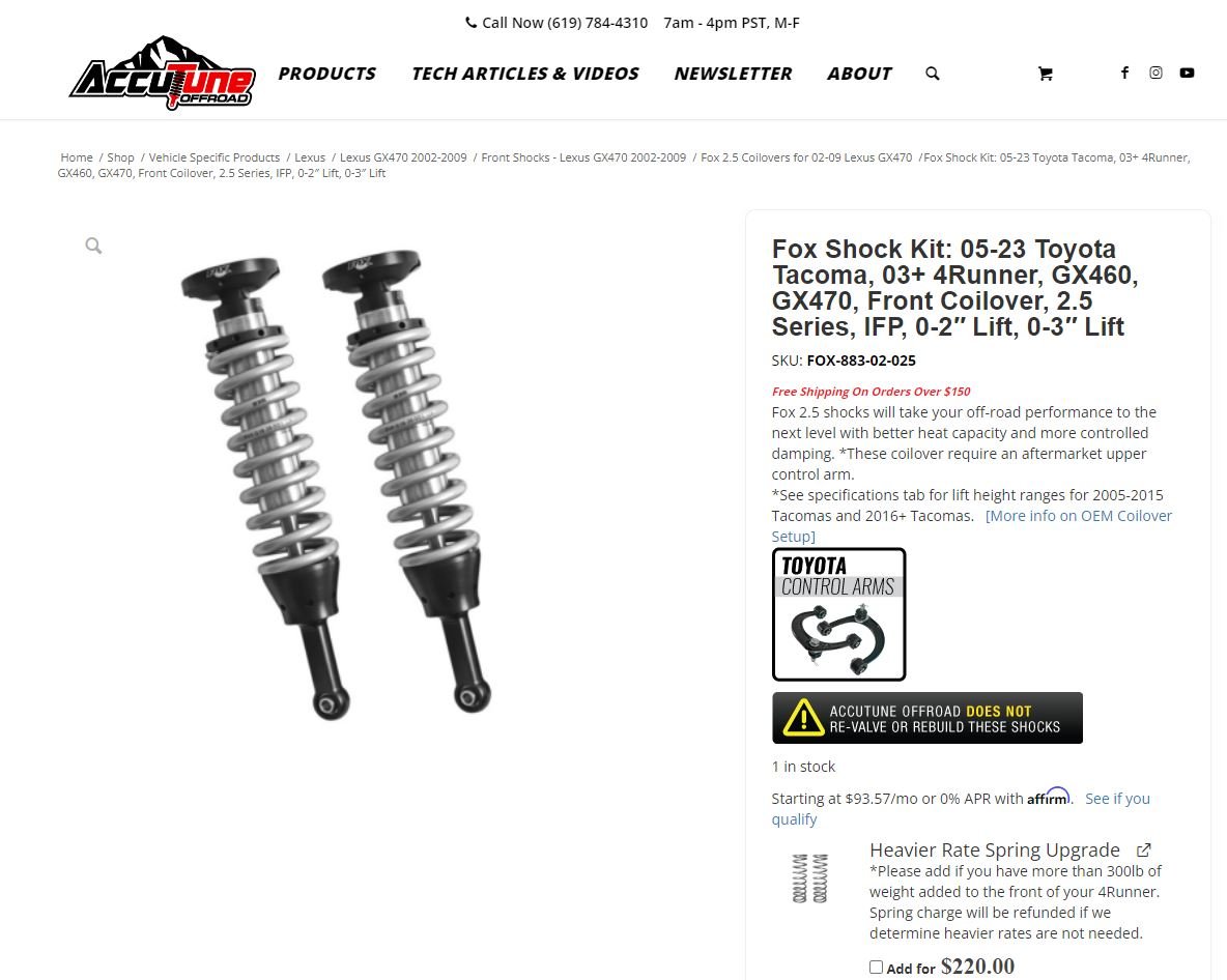

    Looking to piggyback on this thread with a similar question. Any experience with the 2.5 IFP non-resi? Part #883-02-025.
    I noticed on the Accutune website it states that they do not tune or rebuild these shocks. Sent an email to them asking about these but haven't got a response.
    Mainly looking at these coilovers to get around the 2.5" lift range, keep it adjustable, but be more budget friendly.
    I don't need high end suspension to cruise around the mountains at slow speed. Not desert running with this thing. Any reason not to go with this set?

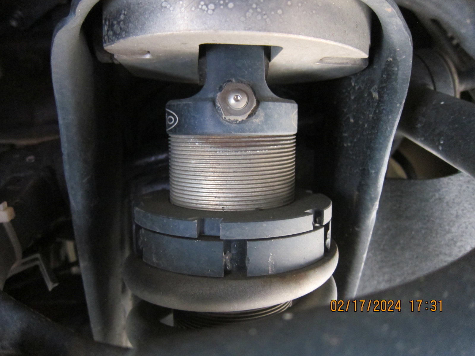

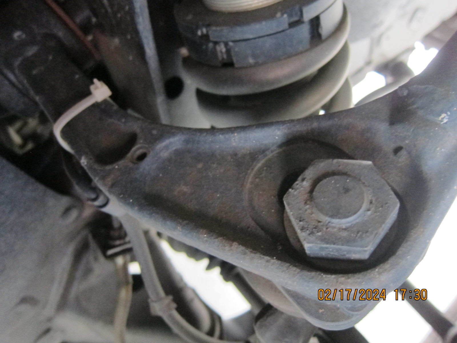

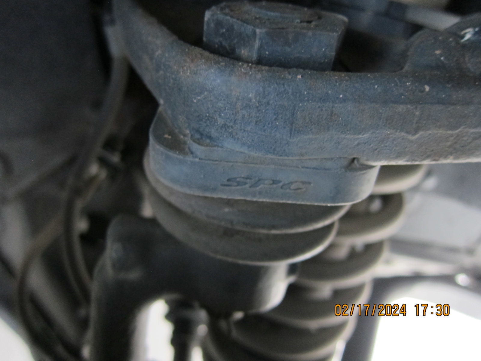

    Crawled under the truck and took some measurements.
    Have a 2" lift on truck.
    Actually found the UCA markings, they are an older model SPC - combined tubular and flat, no grease zerks. I'll put some pics.
    Also found a broken CV boot... FML.
    So... I think I may go the route of replacing my radflo 2.5 with something new - probably fox. Replace the CV axle, then get the truck aligned and shocks tuned. I think that's going to put me in the 4K range for cost. I called a local shop for the job and they quoted me 6.5K (no CV axle replacement) - which is not worth it for me. around 4 and a several hours of self labor... I think it is.

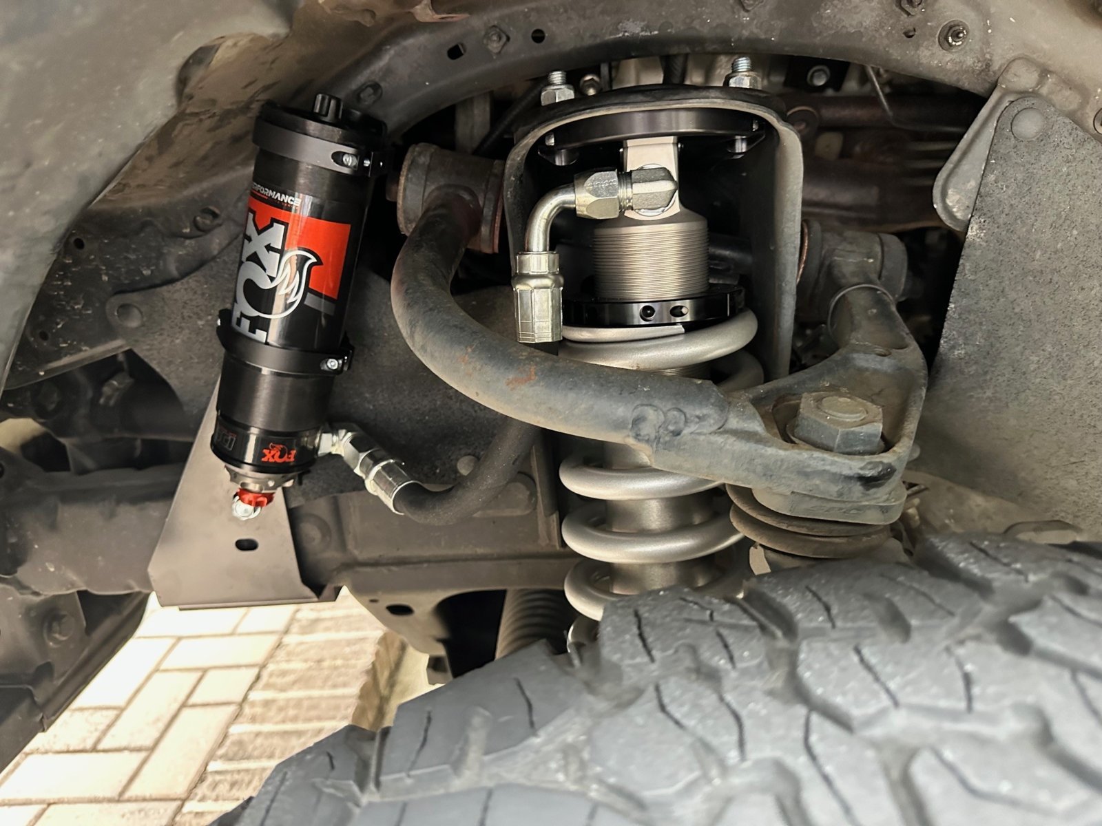

    Thanks for all the opinions. I bought the fox coilovers.
    So far I've got the front installed. I had 2" lift to get go and did not adjust, ride height is within a 1/4" (slight increase). Going to let them settle and see if I need to do anything.
    Of interest I found my UCA on the passenger side had lost it's nut and washer... I spoke to SPC and they are sending me a replacement washer (apparently it's something special). They also said they've discontinued the bushings for the old style and have an upgrade program for new arms, around $250 to upgrade. I'm holding off as I've seen a lot of negatives about the new x-axis bushings. Seeing as I've been driving around like this for awhile and the bolt doesnt seem to be moving, I'm going to keep tooling around town this week until I can fix it.
    Once I get the rears on I'll update on ride

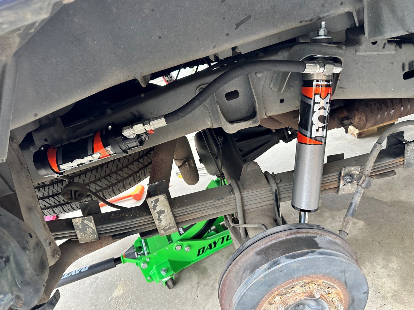

    I didn't. Installed them straight out of the box. Didn't adjust anything and ride height stayed the same with a 2" lift.
    Got the rears on over the weekend.
    Didn't notice much with replacing the coilovers, the rear shocks helped a lot. These do look nice. For those that have these, I could not get the rear reservoir to install like the picture in the directions with the hose pointed up on the reservoir. I wonder if there was a design change?

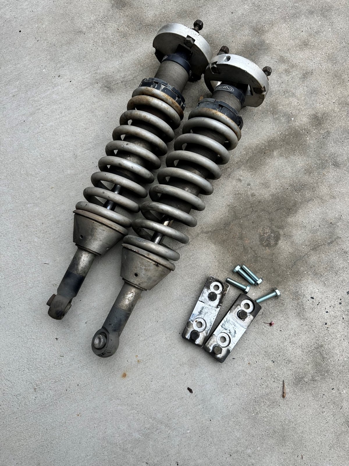

    The old radflo coilovers are ripe for a rebuild so I'll probably just list those for sale and see if anyone wants em.

    You can carefully rotate the hose connection at the reservoir to change the orientation of the hose. Be careful not to loosen too much and lose oil, or tighten too much and damage the aluminum body on the reservoir.
