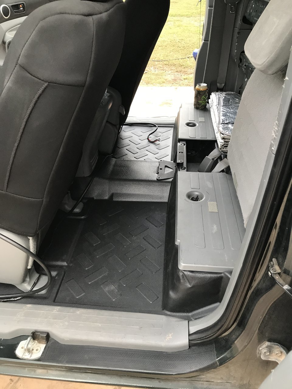

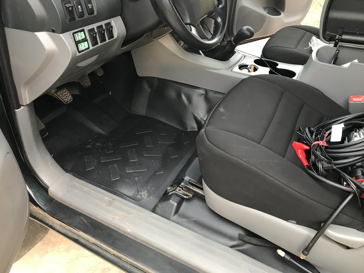

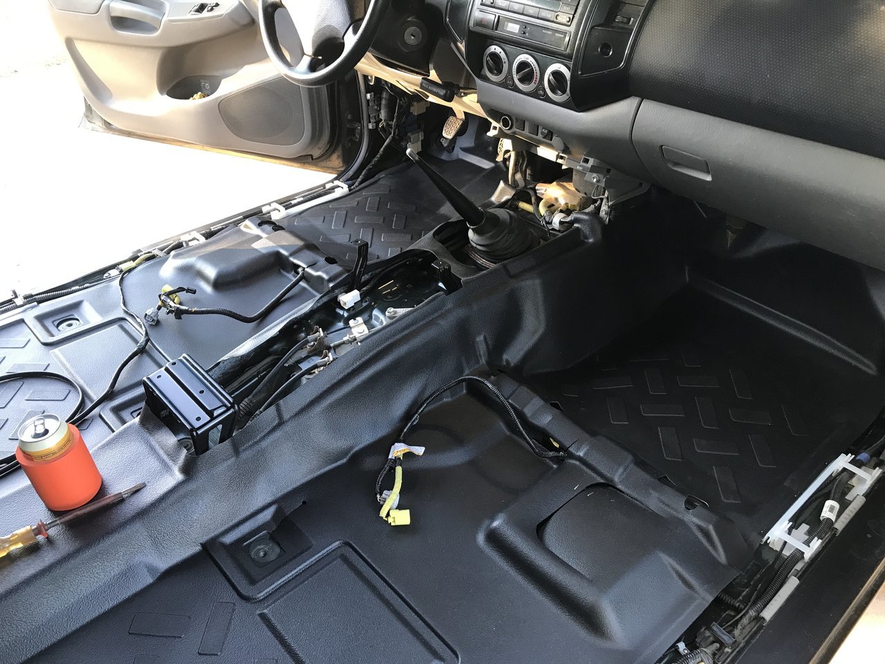

    And here are some necessary pics of my access cab

    @rjbiii, did the wrinkles/puckers that seem to be in the vertical pieces, like the trans tunnel and rear storage, become smoother with a bit of time and or warming up?
    While you had everything gutted, did you use that opportunity to do any other mods, like wiring for any accessories, sound deadening, etc?
    Is the material thick enough to be nicely durable?
    More pliable (rubber like?) than rigid?
    Does it have the jute backing on it like the carpet? IE you submerge it and it's still going to have to be pulled to dry right?

    Heres a pic i just took of the trans tunnel area today. It doesnt look like its smoothing out much, but im sure it will over time. This is mainly from it being rolled up like a map during shipping.
    I didnt do any wiring mods while i had everything gutted out, but i did clean up some of the brackets in the photos and painted them black because they were rusting due to a couple of plugs getting popped out (up into the interior) while i was changing my u joints, so that was letting moisture in. If one was going to do some sound deadening, while youve got it all gutted out is definitely the time to take advantage of that and sound proof up the cab. I didnt do this mainly because i couldnt really afford to buy all the materials and i wanted to get my truck up usable again asap. I had a leak somewhere in either the windshield or on the top of the cab and that was causing my carpet to mold, so i didnt really plan on replacing the flooring at the time, which is why i was kind of short on funds whenever it happened.
    The bottom parts of the matt where your feet go are thicker than the vertical areas like the trans tunnel, and the area that goes up around the under the rear seat toolboxes. Definitely thick enough all around to be durable for the long term. Also its kind of a vinyl material as far as pliability goes. Not as pliable as rubber, but not as stiff as plastic if that makes sense.
    Yes it has the same jute sound deadening material that the carpet has on the bottom of it so it would have to be pulled out and dried out if you submerged it.
