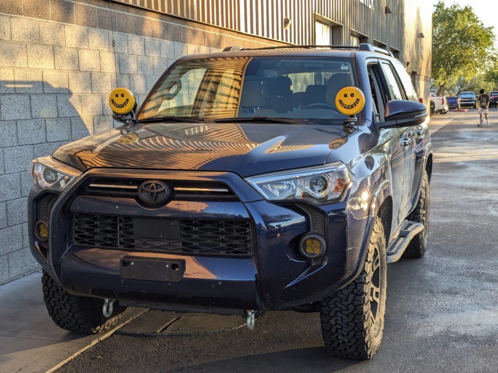

    That makes sense. Hopefully I'll be able to get you on the phone this week. Currently the 4Runner has stock low beams and SS3 Pro fogs that are great. It's our family roadtrip vehicle all over AZ and the west, it's my wife's daily, and we'll do some wheeling, typically not more than 50 mph on dirt, no crazy crawling. I'll probably do the anytime fog mod if I get lights with more punch than the Daylighters, just so I have more width to the overall pattern.
    Looks like the light purchase will be sooner than anticipated and the bumper purchase further out, so whatever we get will be mounted at the A pillars where the Daylighters are. So if I'm restricted to two Titans or Pro6 lights in that location, and I'm not concerned with SAE compliance, only with effectiveness, would driving/spread or Wide-40 be a better option? From the YouTube videos you've posted, spot would be too tight to be the only light.
    I looked at the FE4, and from the beam shots and specs it does look quite nice. How does it compare to a Slimlite? On paper the Slimlite appears to be more powerful, but is it too much to have tied to high beams, leaving me blind when I go back to lows? Or does the Slimlite have too much foreground light and not enough throw? I ask since the covers to switch the beam pattern of the Slimlites as well as the yellow covers are pretty appealing.
    The styling of the Pro6 and Titan are definitely by favorite, but getting something that matches or exceeds the performance of the halogen Daylighters, can be mounted to the A pillars and provides good value are more important than styling.
    Here's the best picture I have of the 4Runner from the front (crawling Costco).
    To further complicate matters, my wife has informed me she'd like a roof light bar in the next year or so, so ideally whatever I get now will work well with that. Hoping I can mount a Gravity light bar of some flavor, otherwise I'll probably end up with a Flex Era bar.
