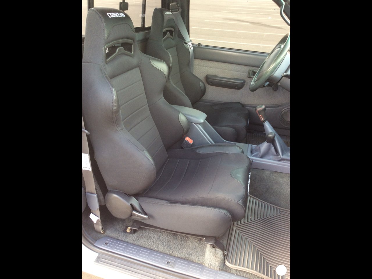

    Well, I went ahead and ordered the Corbeau Seats and Brackets. This am the brackets arrived and I put them both on with no problems. I'm gonna wait until tomorrow (Too freakin Hot out now) to install the Pass side and see how it goes. If my back allows I'll do it myself. If not, then I'll take them to my Mech. And let him deal with it.

    Corbeau seats brackets are direct bolt in specific to our truck.
    You can buy used seats with Corbeau brackets or their seats and it’s very simple.
    It’s an easy install

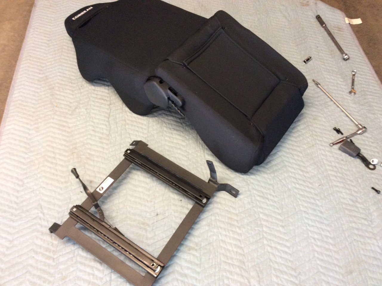

    The project starts.....Humid as it can get. Brackets on
    1997tacomav6 likes this.

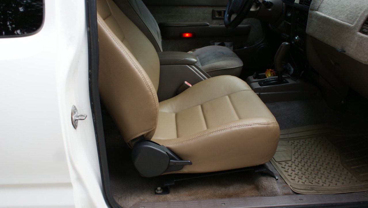

  11. Aug 18, 2019 at 7:55 AM
    #31
    KdF
    KdF Old Rednek Type
    Jul 13, 2007
    #2079
    953
    East-ByGod-TEXAS!
    2000 Prerunner SR5 TRD 2WD
    Looks so much better

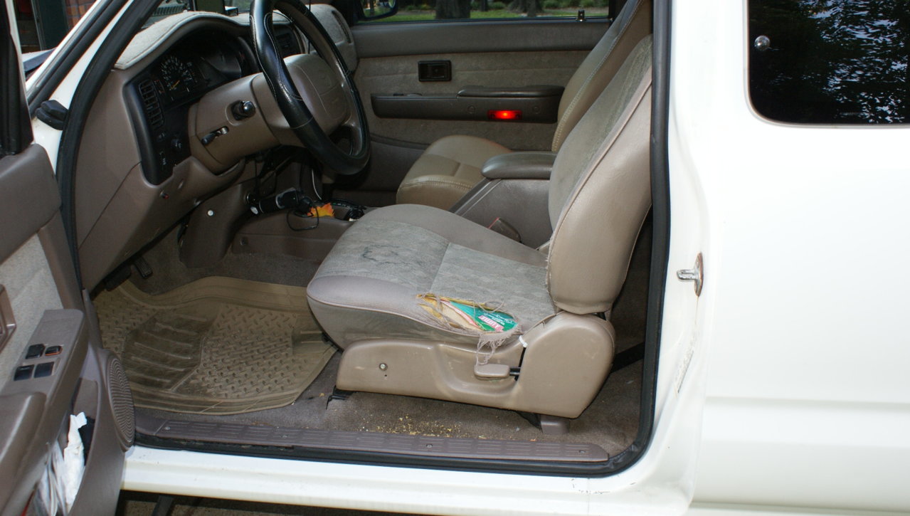

    Out with the old one 1st, doin the passenger in case my back goes out, I can still drive it . 14mm and 4 bolts

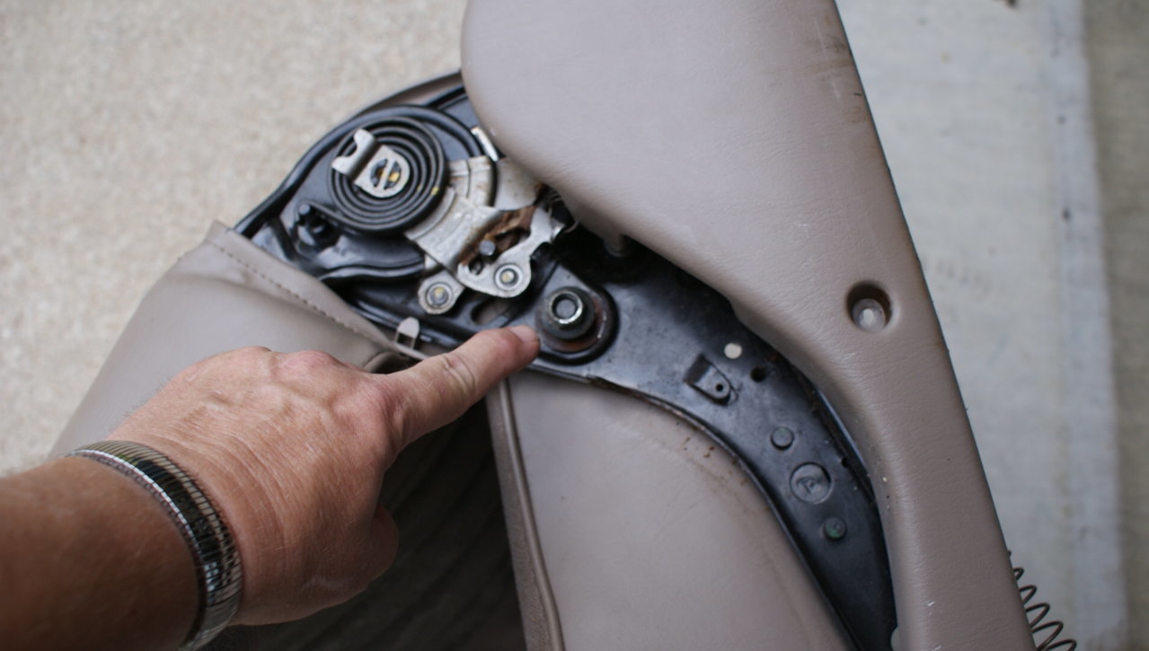

    Only problem of the day, The bolt for the seat belt retainer "DOES NOT COME OFF!". It is part of the seat frame, lucky me I have the bucket of bolts, nuts and screws every shade tree must have.

    One side done. Still unsatisfied with the seat belt retainer, as they do not come with hardware. Oh well.

    Now to get rid of this ugly worn out seat.

    Don't forget the seat belt warning light wire, as some states will not let ya pass inspection with the light on.

    If you use the Corbeau brackets they have the seatbelt bracket part of the frame and you just bolt the Tacoma seat latch to it.

    Fini! Zip tied the wire out of the way and now I'm soaked. Need a shower this early, but done.

    I know where and what it is, there was no bolt to use with it. Had to find 2.

    Yup, have to get a few bolts and lock nuts
