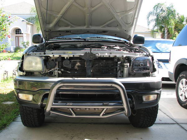

    Yes, you will have to remove the grill - mine below during light swap:
    No big deal though. Just be careful not to break the clips on the grill; they are not very beefy.
    Lots of options for lights on e-bay, but you get what you pay for. Most people on here run a bead of silicone along the seams of the new ones to seal them since some have experienced condensation on some of them.
