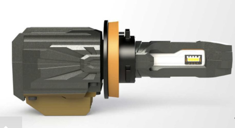

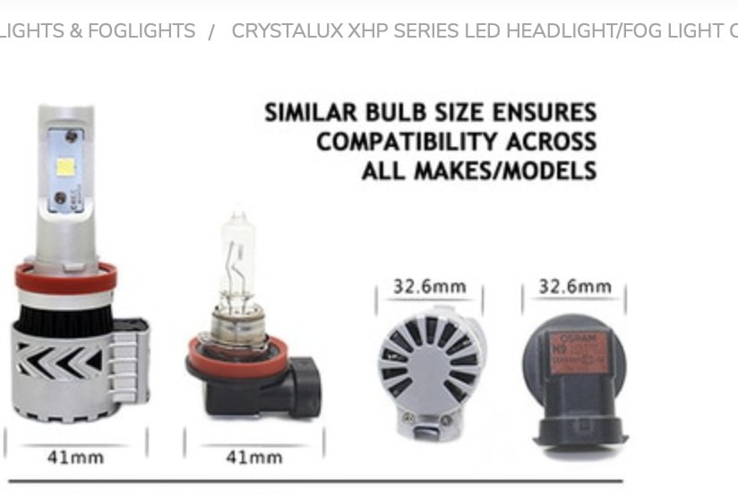

    Do you have a compliant FVMSS 108 test result using a Tacoma headlamp assembly to back that statement? Many LED companies make the claim their bulbs won't cause glare and it is almost always inaccurate in a reflector assembly. The multi-pattern (high/low) reflector of an H4 headlight is even more inherently problematic for LEDs, as stray light into the high beam reflectors create significant glare. To minimize this the LED design needs to very closely replicate a halogen filament in all 3 axis. The CrystaLux bulbs shown on your site have oversized emitters that do not accurately match a halogen filament, meaning glare will likely be an issue.
    Note how the Crystalux emitters are bulky/square and don't match a filament:
    Here is an example of emitters that closely match a filaments X and Y dimensions, it is still a little wide in the Z dimension though (cross section/thickness):
    Granted these are H11, but you don't have pictures of H4 LEDs on your site to compare.
    The other issue is output. To not have increased glare you need to have near stock output levels. This is one of the reasons why companies like Philips and Sylvania make their LEDs with output levels to match the halogen lights they replace. Your site lists 6000 lumens for your CrystaLux bulbs, but presumably that is raw output for both bulbs combined. That would be 3000 raw lumens per bulb, so possibly about 2000 actual lumens if using good quality emitters with sufficient cooling. Meaning you are well over the 1000 lumen 9003 compliance requirement, and having a higher output light source causes more glare.
    Interesting in halogens, performance bulbs like the Philips Racing Vision GT200 bulbs I mentioned in my earlier post still produce stock/legal lumen output, but they get substantially higher output intensity by shrinking the filament which increases focus and greatly boosts output intensity, making the projected output brighter. Here is an article from Philips on how this works. Unfortunately LEDs work a bit in the opposite way, since smaller light sources increase focus which boosts output intensity, larger/bulkier light sources like LEDs reduce focus (which also causes more glare) and reduces output intensity. It is possible that even though the LED light source is brighter in total output, performance in output intensity (which directly translates to distance projection) can be actually worse, due to the poor LED focus. Also unfortunate, this manifests in increased foreground light, which people naturally favor but comes at the cost of reduced distance light. And that is exactly what you don't want in a headlight, but people are very poor judges of light which is why instrumented testing is so important.
