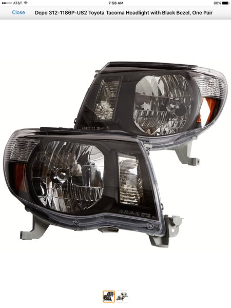

    Something like this?
    Zac of all trades likes this.

    Ok, you're talking about the housing. They are a crap shoot. Sometimes they are perfectly fine. Sometimes they leak and get foggy.

    Yes those are the cheaper ones you can find on Amazon and ebay with projector lenses.
    If he is wanting to just upgrade the bulbs in the headlights then he should be fine with the ones he has. However many people that buy the crazy bright LED headlights have projector lenses in their headlight housings.
