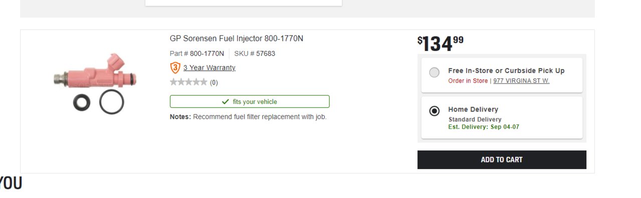

    This is the injector we first tried from autozone. The picture has the OE style pink ring but the ones in stock did not have it.
    We ordered one from Advance Auto and its a intermotor brand, again the picture has the ring but the one he received does not.

    They should have the ring. I'd check rockauto for their part number, that where I bought my replacements and they fit correctly.

    I had him pick up a injector seal kit and it work, no leaks.
    In the kit there is a seal you slide over the inlet side of the injector down past the o-ring. It looks different than the others as you can see the seal protrude a little but it is holding pressure and the truck is running smooth.
