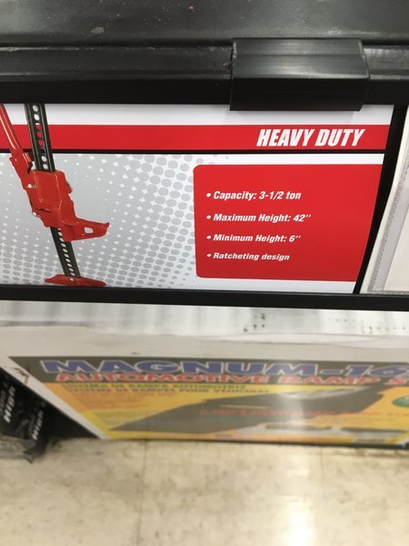

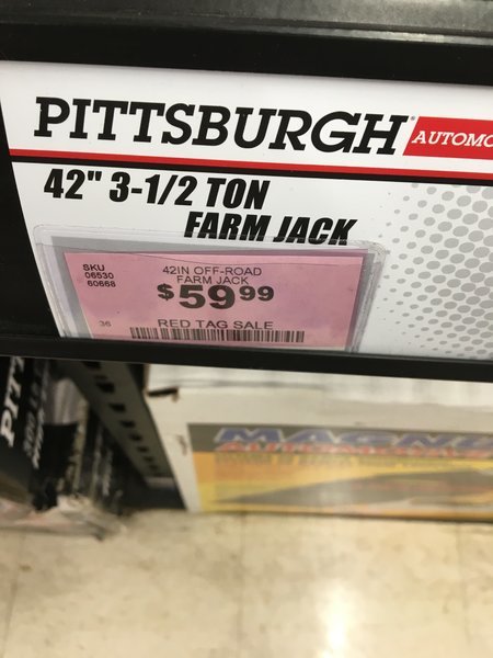

    Is the factory bottle jack useless after a lift? I understand that the rear axle height hasn't changed (unless running plus size tires) currently I'm on 285s with full OME lift. However I know the front could be an issue too. My local harbor freight has an aftermarket farm style jack for $60.

    Hi Lift style jack should be enough then. I have a 48" and can barley get the rear up with Dakars, provided I don't take the jack beyond 3/4 the way up. I would go for the 60" if you can.

    Not really, most if not all of the factory points are out of reach for a hilift. The only spot you could maybe do would be on the pinch weld, but I don't like jacking off that, let alone with a hilift. It will put the whole jack waaaaayyyyyy to close to the body panels.
    If you want to get the most use out a hilift, you should look into getting some sliders/steel bumpers or at the very least get their wheel lift kit. Basically hooks a strap onto your rim and then hooks to the jack then you can jack up the wheel.

    Pinch weld would land the top of the hi-lift right into your door. They are useless without sliders or other aftermarket jack points.
    I put the stock scissor jack under the axle in the rear and under the control arm in the front. Works just fine if I need to swap a flat.
