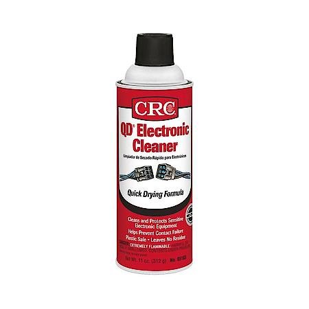

    This is the only thing I use on electronic connectors and used it on my spark plug coil connectors. =>

    You were correct in your first statement, because putting insulating grease can only cause a connection to have poorly flowing electric current through a plug and will never help make the contact better in the long run.
    The person in that video was pressing down on the contact one time and i would not trust a connector in your Tacoma, which is vibrating with a force less that he applied over the long term. He may be right making contact one time, but i would not recommend putting it on pins, like you said in a moving vehicle IMHO.
