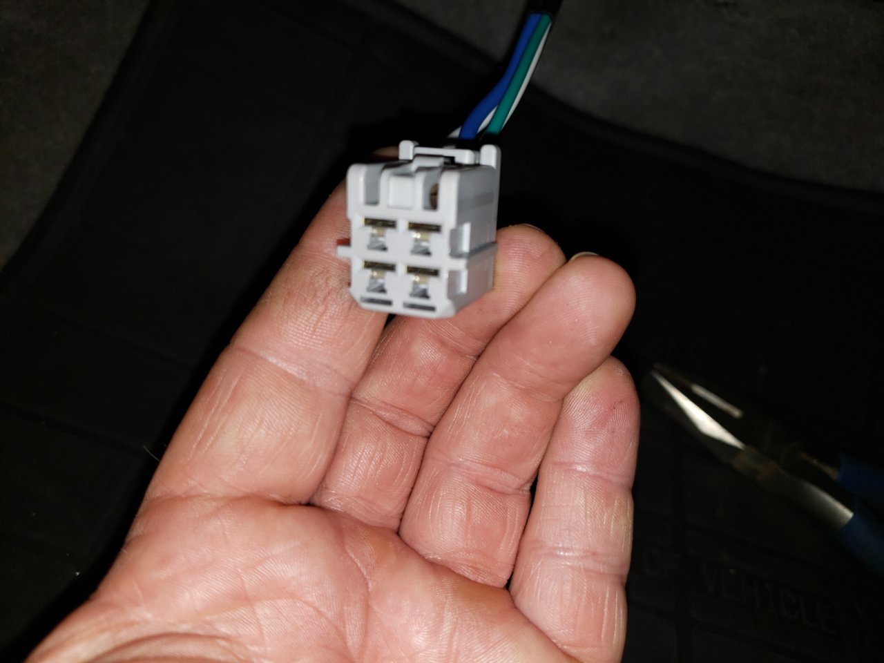

    Any chance white goes to white/black and white/black goes to white/blue. Looks like the white/blue goes over to the blower?
  2. Dec 17, 2019 at 7:33 AM
    #142
    Muddinfun
    Muddinfun Well-Known Member
    Apr 17, 2017
    #216500
    7,489
    Is the resistor the OEM type with all 4 terminals in a row? If so, compare the order of the colors.
  3. Dec 17, 2019 at 7:39 AM
    #143
    Dixietaco07
    Dixietaco07 Member
    Mar 24, 2019
    #287772
    11
    No its updated square type

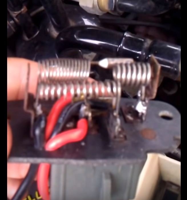

    I had this problem on my old Ranger and just hardwired the resistor bank to the wiring harness. Never had a problem again (grainy pic I snapped from my video, lost the pics a while back). I used RC 12g silicon wiring and just drilled a few holes in the plastic mount to thread them through.

    I ordered the resistor/connector kit from Amazon and can confirm the connector is a Metri-Pack 280 female 4-way connector. You can get these plus the pins, seals, and tpa clip for about $5 from Del City if you prefer not using butt splices on the prewired kits. You could depin the 3 that aren’t toast and just replace the one bad pin. The similar part for Chevy has a good size heat sink attached to the resistor module on one side so I’ll be doing that as well to see if that eliminates the overheating problem the module has. The connectors are rated for 30A so the problem is with the module producing the excessive heat, the connector would not otherwise fail.

    I also think there’s a good chance that at least some of the connectors sold on Amazon are knock offs of the metri-pack connector as the one I just depinned used very thin metal to create the pins and this would drastically change the current rating of the connector since it’s the pins and not the plastic that give it the 30A rating. At this point I’ll probably order new genuine pins for it.

    I think the issues are a combination of things. Using genuine pins is definitely a good place to start, that said I would be curious to know how good the tolerances are on the male pins on the resistor itself. If they’re undersized or inconsistent it could lead to issues (similar to what happens with the Molex connectors on the seat heater modules of the newer trucks).
    If it was me, I’d be switching to the newer style without the Metripack connector. I really wish Toyota had just used a Denso HVAC system in the Tacoma instead of the Delphi stuff.
    It seems most of the time Toyota uses Delphi electrical components they end up being less reliable. Which is too bad because they actually do make some decent stuff (GT-series connectors are great among others), but it just hasn’t worked out well for Toyota compared to Denso stuff.

    Here’s the pinout between the old and new connectors:
    Pin 1 (White/Black) to Pin 4 (White/Black) - LO, to Chassis Ground
    Pin 2 (White/Blue) to Pin 3 (White) - HI, to Blower Motor
    Pin 3 (Blue/Black) to Pin 1 (Blue) - M2, to Control Switch
    Pin 4 (Green/Yellow) to Pin 2 (Green) - M1, to Control Switch
    White/Black is always ground for Toyota. Always.
    The colours on the new harness correspond to the colours used on 2016-2020 trucks, and what was posted in that other thread seems to be correct.
