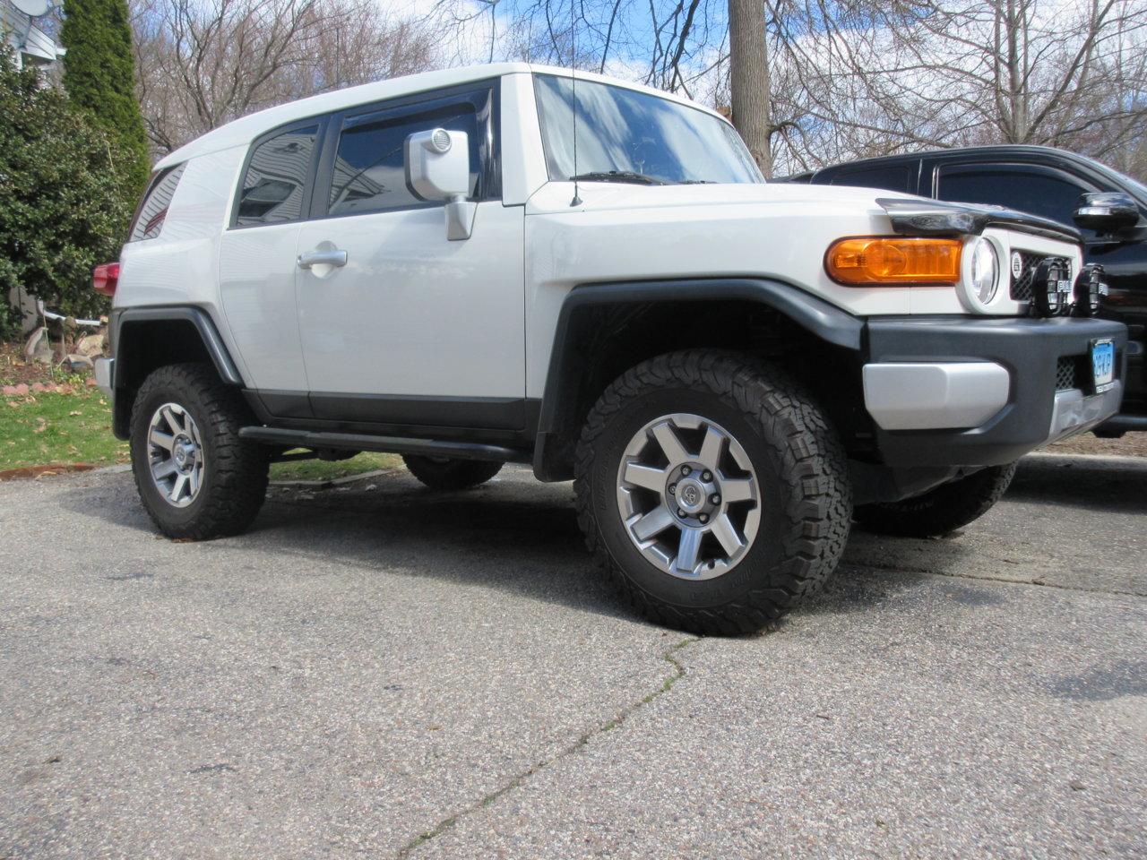

    I went with the Toytec BOSS setup on my '14 a couple years ago. Fronts are adjustable and I added Superflex springs in the rear.
    Lifted a couple inches and it sits right now with a slight rake. Ride quality is much improved, getting rid of the notorious "FJ Dip" while braking and accelerating. I'm running 275's as well.
    Couldn't stand the mushy stock setup.
    It took longer to adjust the front height and even it out than it did for the install.
