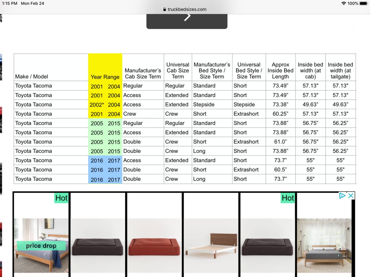

    Thanks for the reply...only reason I was second guessing is the vehicle fit tool on their website says it wont fit...but later 2nd gen model years would. I didnt think anything would actually be different

    To assure yourself, you could compare the pickup bed dimensions to yours with the ones that it says it does fit.

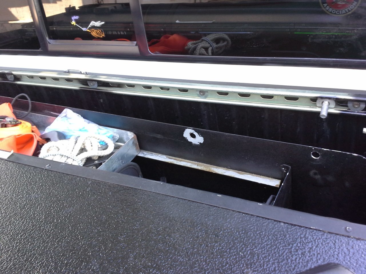

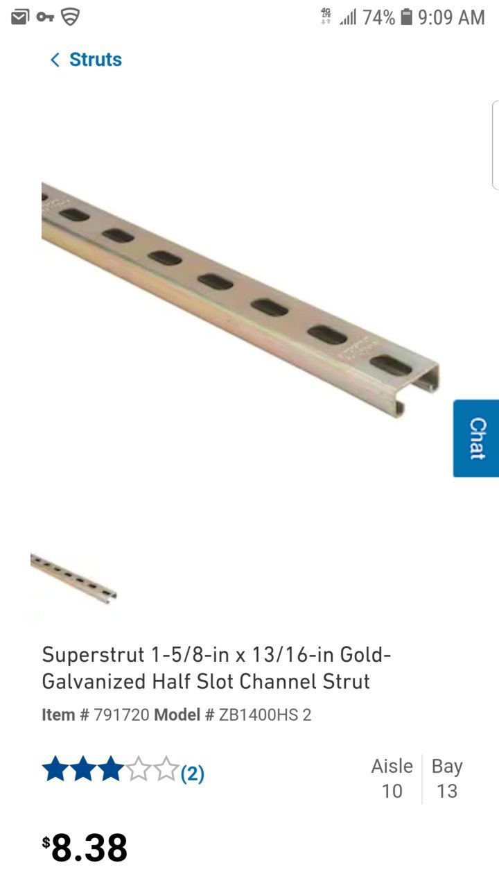

    If you looking for function not caring too much about looks this rails used to secure electrical conduit can be another option (frugal ) lol. Will look for pics on computer to see how I used it .

    @hemitruk where did you purchase those channel strut bars? And did you have to do any cutting to get a decent fit?

    Home depot in electrical section. Just had to cut to length of bed.

    I used 1/2inch carraige bolts and flat washer . Had to grind a little to fit . Yes homedepot carries the bolts also .
