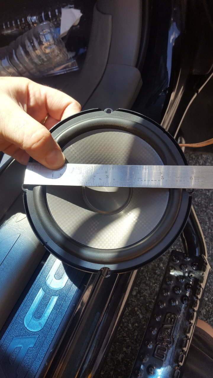

    This is the speaker that went bad:
    I don't know a ton about car audio which is why I bought the kit that had speakers and crossovers. They are being driven by the factory head unit going into an amp (line level) feeding the crossovers and into the speakers (if I remember correctly).
    Can I just drop in a pair of basically any speakers of the same size?

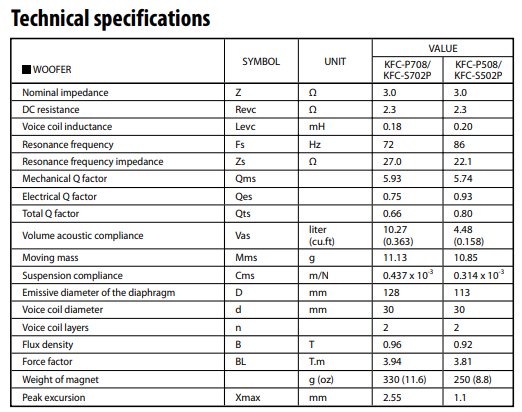

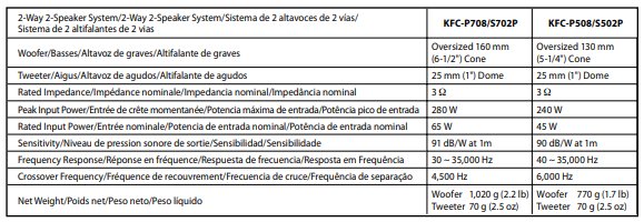

    For reference.
    4500Hz is pretty high to be trying to find a midbass speaker replacement. 3 Ohms is ridiculously rare as well. I think by the time you find something you're about into a new comp system money. If I were in this position I wouldn't think twice about buying new stuff.
