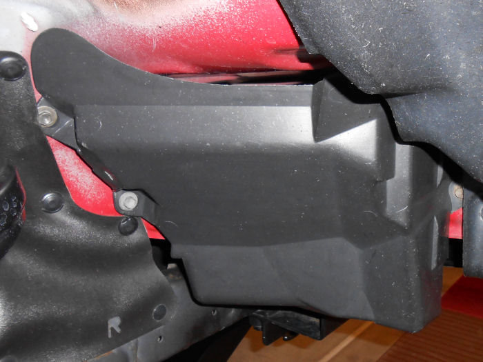

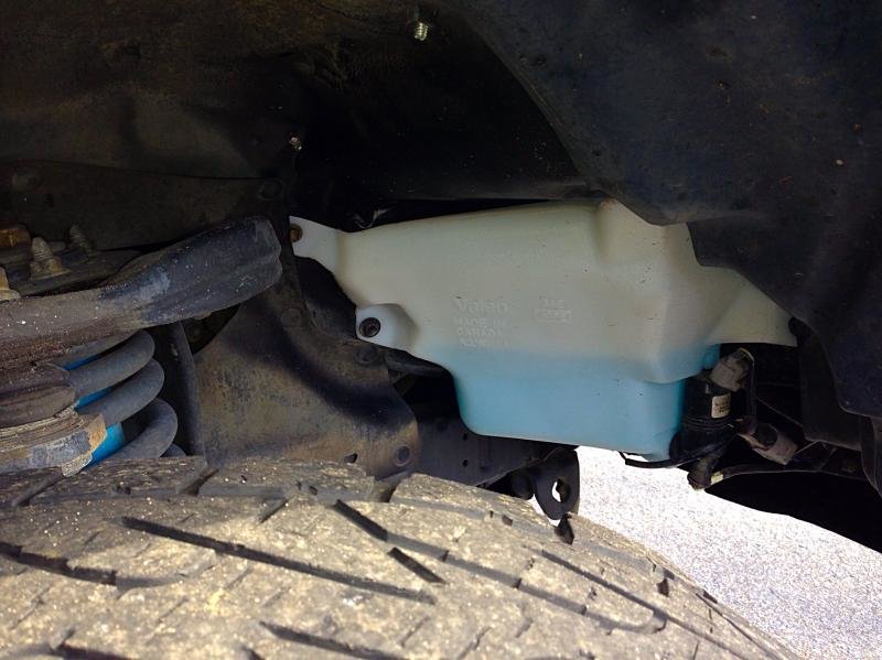

    I have a 2000 Tacoma 4x4 TRD and just got it back from the body shop. They had to replace my windshield fluid reservoir...
    Question:
    The reservoir sits in the wheel well behind the front bumper; is it supposed to be exposed in the wheel well or is there supposed to be a protective cover?
    This is how it looks now, I cannot seem to remember if it had a cover or not but common sense tells me that it should since it is designed for off road use....

    It seems some have it and some don't. It's not clear if it was part of an option package or trim level. They pretty much go the way of the Dodo when 33's or larger go on.
    FWIW, the manufacturer of the original factory tanks changed at some point and with good reason. Delphi was the original OEM supplier, looks like you have the newer one.
    Additionally there are 2 different tanks, "standard" and "cold weather". The standard tank does not have a cover. Below is the cover for the cold weather tank.

    yes, you should have had one and you do need one, they forgot to put the cover back on it, many with big tires damage theirs so they leave them off but it should be covered to prevent rock damage as well as bad electrical connections an hose issues.
