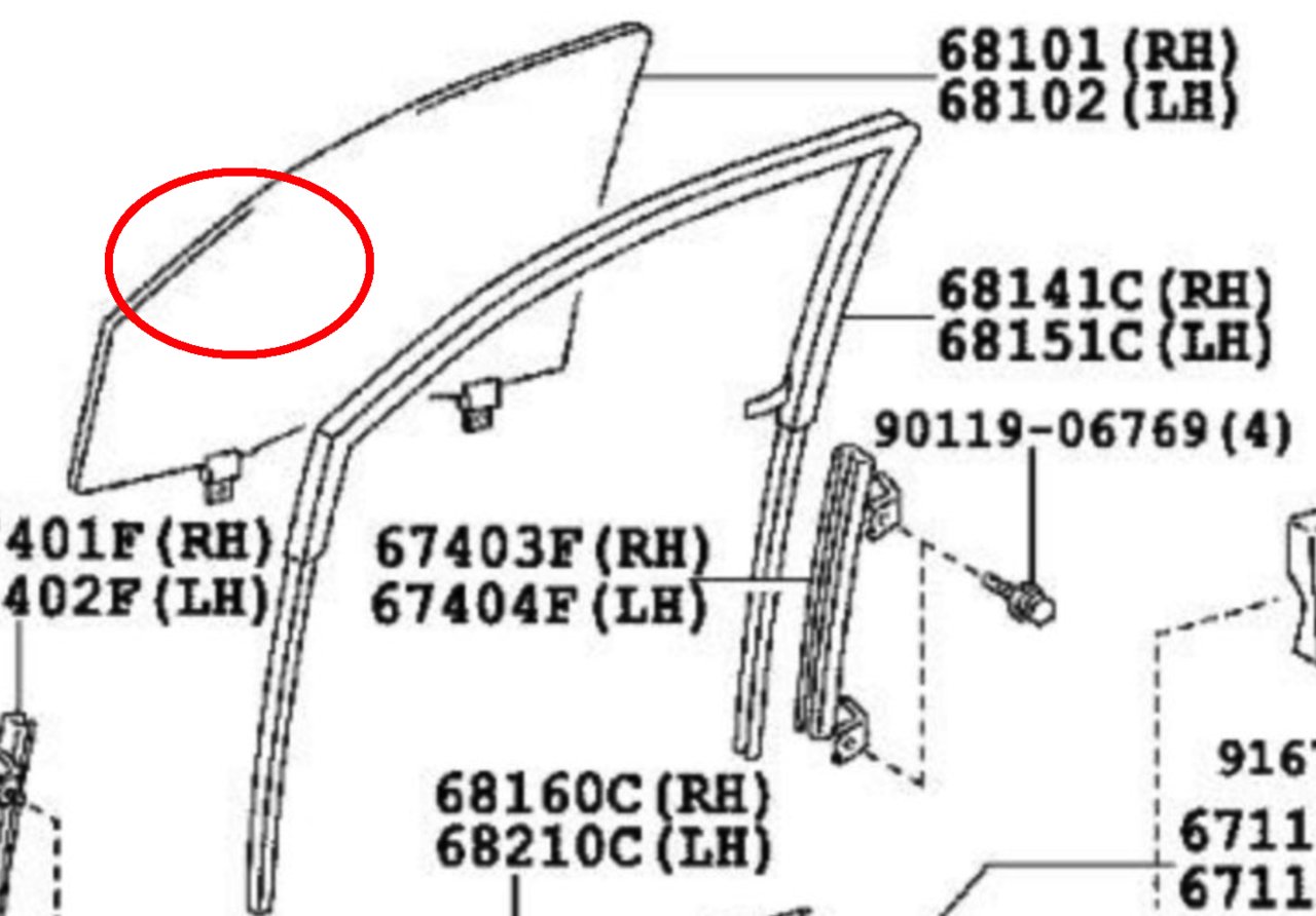

    I did a search and almost all of the results are about the window "belt trim" where you'd rest your arm with the windows down.
    I'll replace that too, but it's not what I'm looking for. I want to replace the trim around the rest of the window, like the top near the front where it curves. Basically all the trim.
    My 2011 whistles and shit like crazy on the freeway, especially with a crosswind, from both front door windows. I can push outwards and it goes away, which makes me think it's all the old, dry trim.
    Thoughts, ideas? I've cleaned and oiled them, no help. Living in Vegas all of the trim dries out.

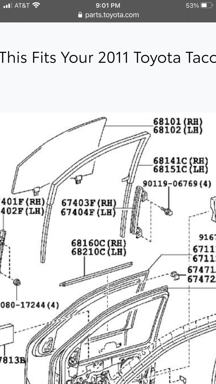

    Post pic of what you’re looking for

    ADABDEAF-E787-4780-80B6-B8314CBF788F.jpghope this helps

    It’s called a window channel. That should help your search

    What's a "Kazoo" type noise? And haha yes window channel is what I need. I'll 1000% buy that entire kit you just posted, for both sides.

    Ohhhh the little toy we annoyed our parents with as kids. YES. My truck sounds like a Kazoo on the freeway, especially during crosswinds, and it's loud AF.
    I push on the window (from the inside while driving) near the red in the photo below and it stops. OK. Awesome. I need the revised door seal soon, cuz it's real bad. Thanks man! Do you have a specific link or product #?

    Also, check out this potential super cheap fix.. He shows where to put it, which puts more pressure on the weather strip seal and prevents the howl and kazoo noise. Might try this before buying all of Toyota's stuff.
