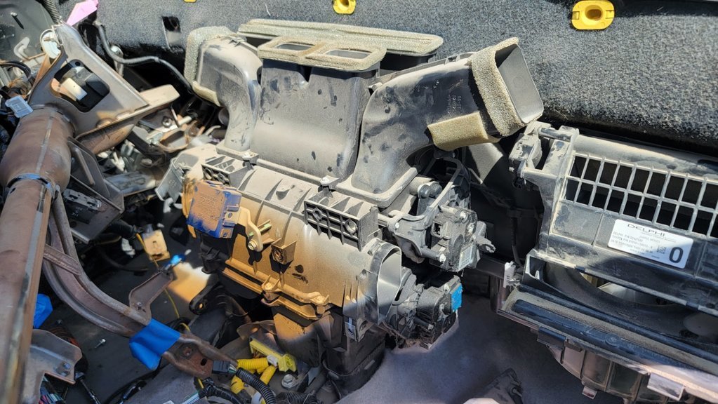

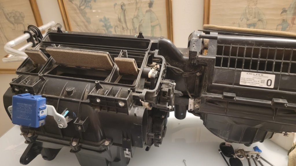

    Only have to remove dash if you are replacing the evaporator. Ask me how I know!
