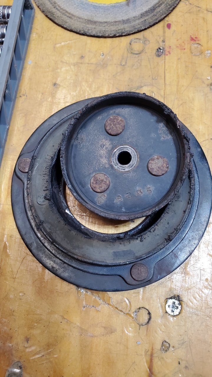

    Wanted to provide an update on my original post. The initial problem was the AC wouldn't stay on and Techstream was showing error B1422 (Compressor lock active). Toyota wanted $2200 to replace the compressor and recharge the system. A friend of mine said there is really nothing much in the compressor that can go wrong and highly recommended I first try replacing the magnetic clutch. I bought a used compressor (with mag clutch and speed sensor) that came from a salvage 2019 Tacoma off of ebay. Replacing just the mag clutch fixed it! The only thing we removed was the skid plate but getting the snap ring off for the magnet was a royal PITA. Anyway... if your AC goes out I would definitely looking into replacing the mag clutch before replacing everything. Toyota dealer will not replace just the clutch.

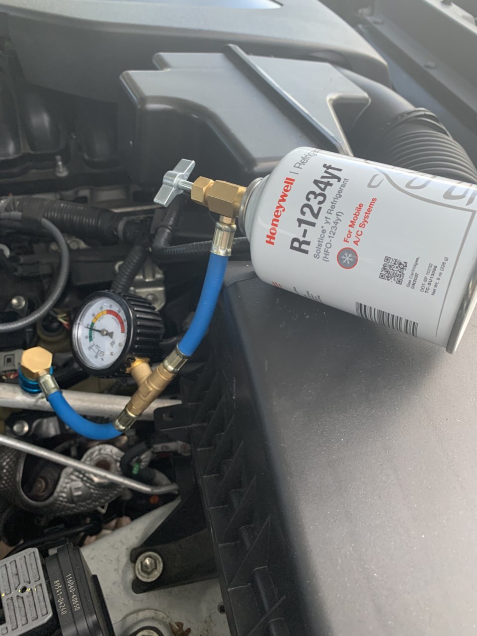

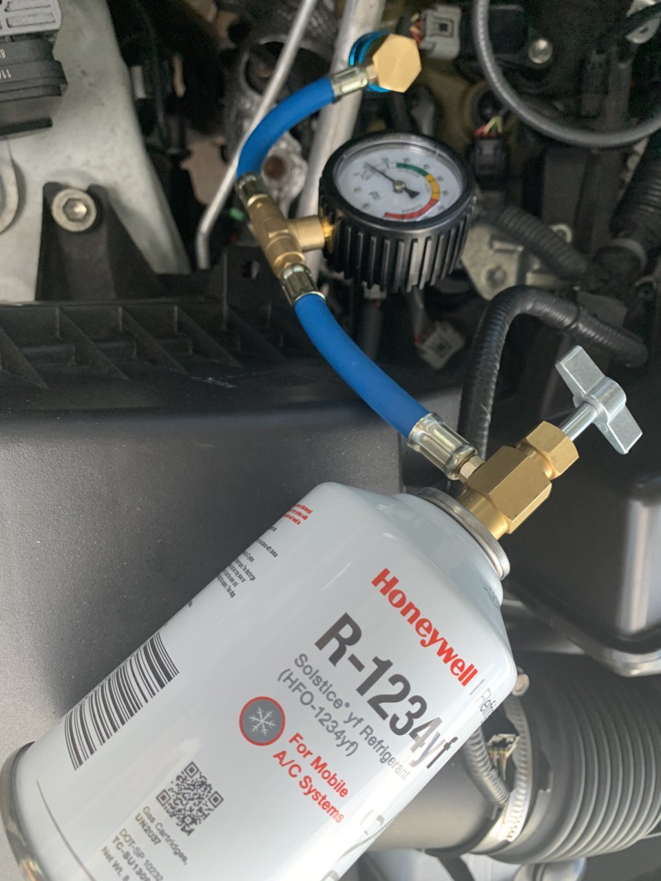

    I just charged my ‘16 yesterday. Due to sitting so much last year from work from home, I believe I lost some refrigerant and the AC was blowing room temp air. I bought the $70 bottle off Amazon (with gauge) and am back in business. Luckily I did not have a compressor issue as not sure I would have tried to source a vacuum system myself.

    tbrady
    tbrady [OP] Member
    Dec 29, 2020
    #350998
    15
    One other update... I could have done the repair in about 10 minutes had I been more observant. It turns out that the only thing wrong with the original clutch was the outer plate(?), the rubber like material was failing and you could turn the inside separate from the outside. Mine came completely apart once I started messing with it. So... there's a decent chance that just replacing that part could have fixed it. And it would have literally taken about 10minutes since that is on the outside of the clutch and I wouldn't have had to remove even the serpentine belt.
