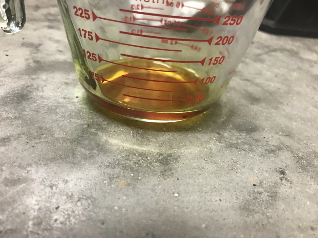

    This is what came out of the old compressor. I got maybe 12 ml Out of it. Does that seem low?
    No debris in the oil, just very dark. I think the last time the compressor was replaced, they did not put oil in the system. Idiots at the stealership... thankfully I caught it before my compressor had catastrophic failure!! It also looks like there was moisture in the system too, because the internal chamber of the compressor was not smooth.

    Interesting. I’ve never done ac work on a Toyota, that’s some odd looking oil. The oil in GM cars/trucks is clear but has a bright green dye in it. That oil looks fairly clean though, you should be good. As far as it being low, the amount inside the compressor itself can vary. The oil circulates throughout the whole system with the refrigerant. As long as you put in the same amount you got out of the compressor you’re solid.

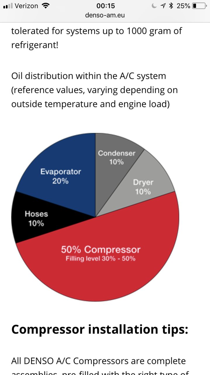

    I put in more... the reason why is because there is this helpful pamphlet on the Denso website.. I have strong reason to believe the system was low on oil and the last time it was replace at, ahem, the dealer, they didn't put oil in the new compressor, which is likely why it started making a groaning noise in the first place.
    http://www.denso-am.eu/products/aut...-compressors/practical-tip-on-compressor-oil/
    I also referenced this thread, specifically post #15 The new stuff I put in was basically clear.

    AC recharged today. So in all reality I put in 100cc into the compressor (after dumping out 100cc of the factory fill), ~40cc (maybe like 35cc because I was trying to put the oil in after it was mounted) in the condenser and 40cc in the drier. That is approx 180cc out of the total of 229cc needed for the system. If we assume that 40cc was in the evap (according to FSM) and a little (9cc) in the lines, that is the remaining amount.
