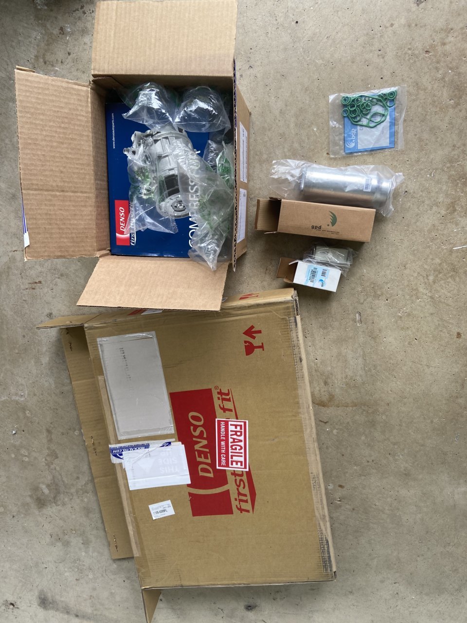

    Hey everyone, resurrecting the thread.
    I bought a new A/C receiver drier, r134a, oil, gauge set, (rented) vacuum pump, and low-pressure oil/dye loader.
    I had the A/C system evacuated at a local shop and asked the tech to let the pump sit & measure the amount of oil that came out. He read 0.75ml PAG46 removed.
    So... My question is: When I take the OLD receiver drier off the system and put the NEW one on (with o-rings) loaded w/ 0.7ml of PAG46 in the receiver drier outtake side and 0.75ml in the low-pressure line before charging when I hook up the pump and pull a vacuum again what stops the oil from coming through the pump? Should I just pull the vacuum from the high-pressure line only and let that pull the oil through?
    Thanks,

    Oil won't come through the vacuum because it's too heavy. That's generally why you oil specific parts in the system directly because it will not circulate much (if at all) when the system is running.

    Thanks ThunderOne. I completely rebuilt the system aside form hoses two weeks ago. It was really easy compared to other jobs I've done.
    Just went out to the desert this week to pick up some things and it was 110 :bananadead: outside and the cab was a cool 65-68 :bananadance: depending on my needs.
    I oiled every part before install as well.
