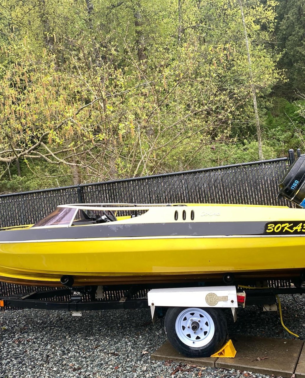

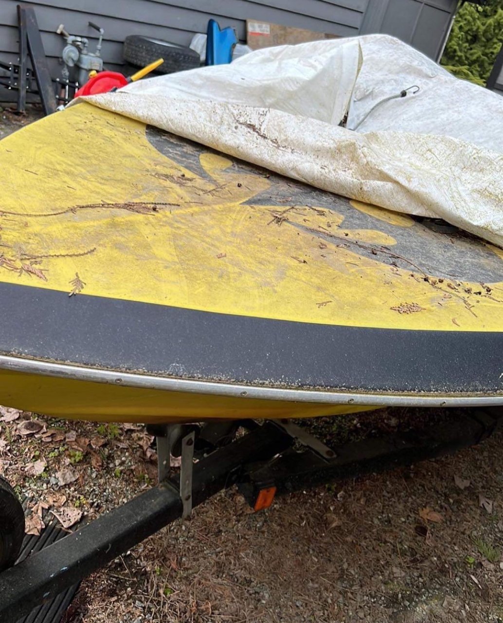

    I also need a forum now for vintage fiberglass boat and mercury motor restoration because I bought this 2 days ago….. for $500 :yes: motor needs some work but I’ll do my best! It’s a 115 hp mercury tower of power. Not sure what I’ve gotten myself into..
    BD553E5D-6395-4D6F-8957-673629F88C5A.jpg 0216C03E-9050-4431-9116-DFF61D8D9058.jpg 3662017E-018D-4920-97C7-3B1906670430.jpg
    Cleaned up nicely!
