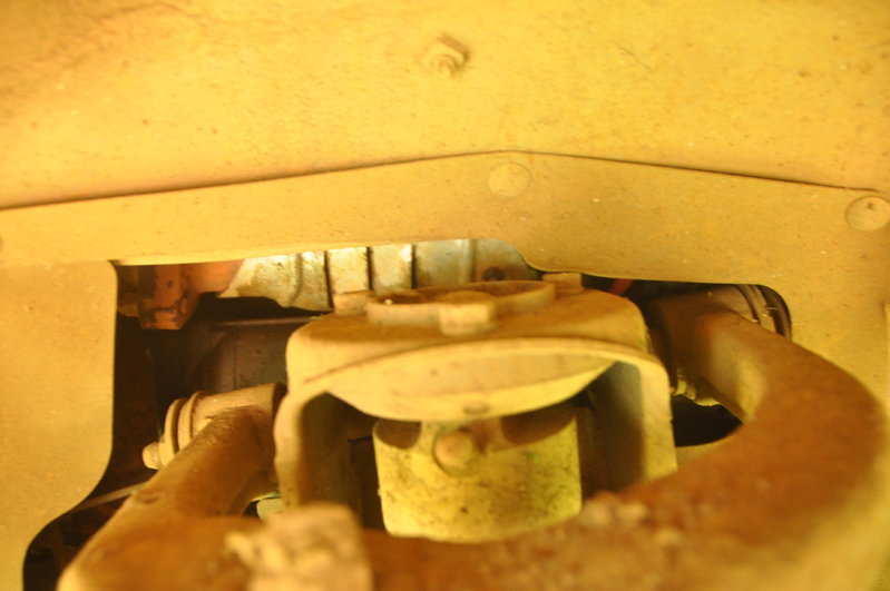

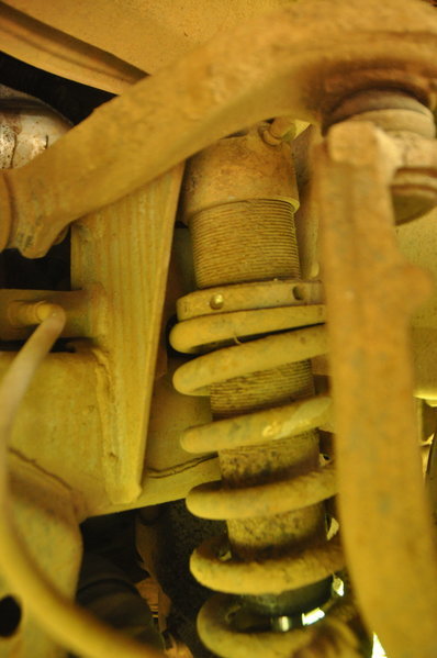

    The current shocks and struts are DR (can't find these anywhere on internet) with what looks to be an adjustable, threaded sort of nut to adjust lift height. See rusty photos-DSC_0845.jpg
    At the top of the strut there are the three nuts to remove the entire assembly but the dreaded center nut that releases the spring pressure is non-existent (see pic below). The main question I have is does the threaded lift adjuster hold the spring tension in??? So when I undue the top three strut bolts to remove the assembly the spring will stay under tension and I can remove it safely?? Thanks in advance for any responses and wish me luck as I am a bit of an amateur and I will have a lot of rust to fight removing hardware!DSC_0847.jpg

    Dr coilovers shocks are essentially icon's. Icon bought out dr years ago. They are a high quality rebuildable race shock. If you wanted you could clean them up an send them to icon and totally get the shock rebuilt, not possible with bilstien or ome. Ome is a good brand of shock though if you decide to go that route.
    Ya you can just unbolt the coilover From the upper shock mount and lca and pull it out without issue. These are a adjustable coilover. Do a quick search and there are how to threads on how to remove and install your suspension.

    Right on thanks for the quick responses! Interesting to hear they were bought by Icon... maybe I will look into sending these back to get rebuilt , thanks for the suggestion. Things like that do get kinda expensive when you live halfway across the Pacific though.
    I had a feeling it would be fine to just unbolt them and pull em out but just wanted to make sure. I'll be loading up on the PB Blaster thats for sure!
