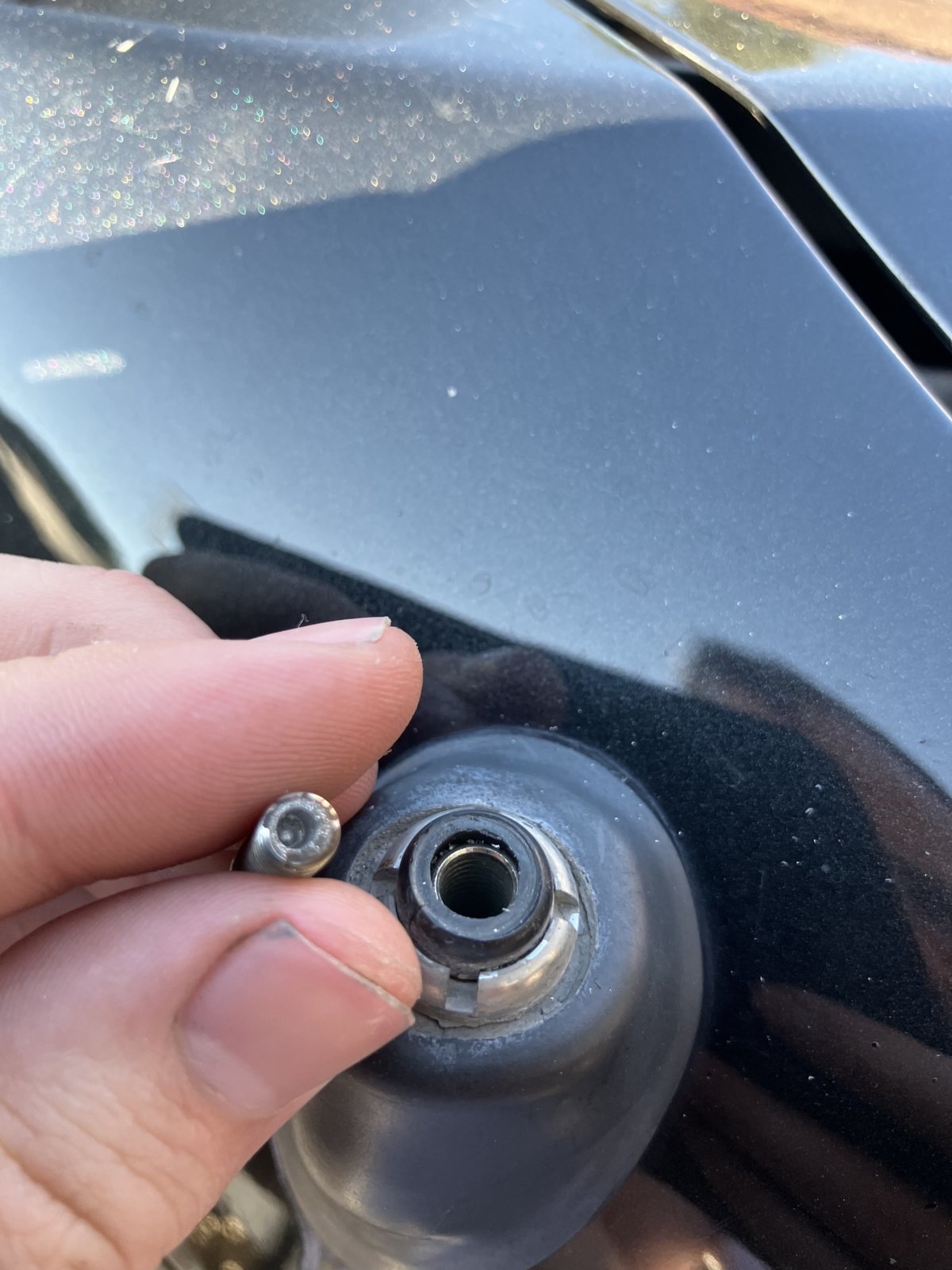

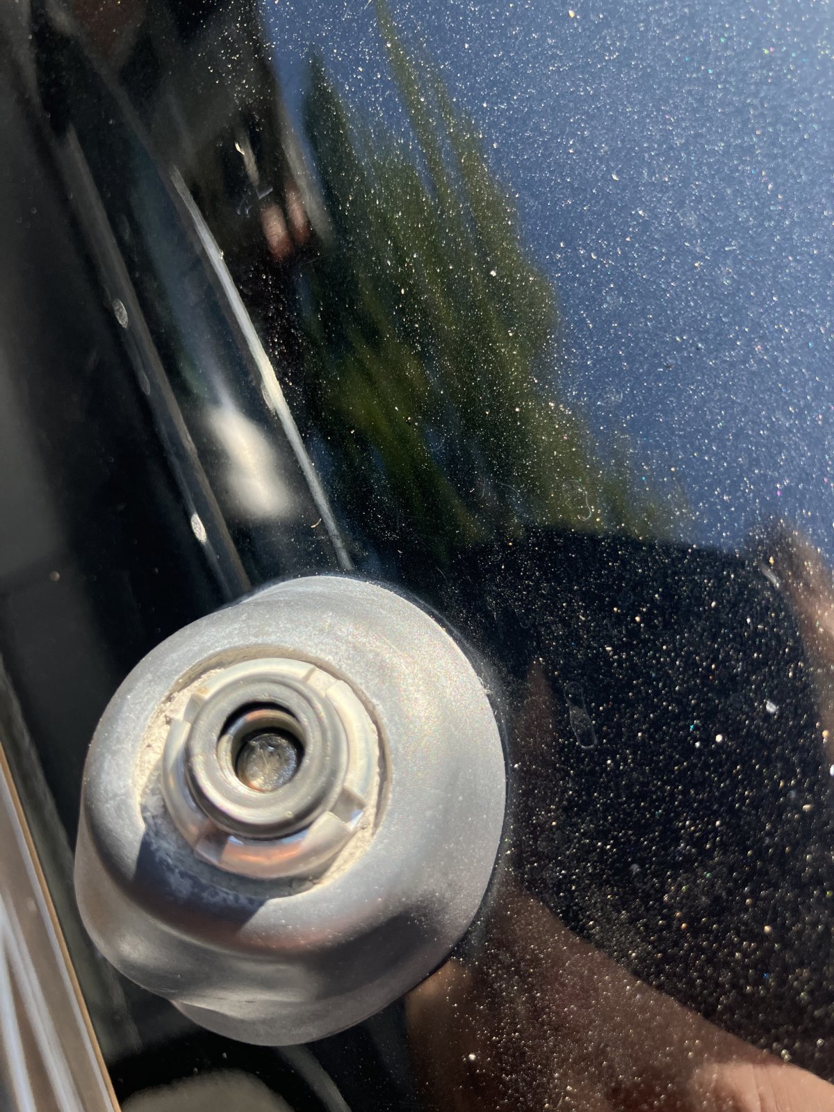

    Am I seeing this right? The old antenna sheared off midway through its thread??
    I goes the car wash applied a right hand torsion on it? (Otherwise it would’ve just come unscrewed).
    I’ve extracted a few sheared bolts before and never had a remotely good time doing it. Any recommendations on how to remove it efficiently?

    According to those that have had the same thing happen.
    That antenna is HARD. It's not easy to drill out.
    Go SLOW, and don't mess up the existing threads exposed at the top by hitting them with the drill bit.

    Put a collar on the drill bit that fits the size of the hole when drilling, perhaps that would help avoid damaging the threads of the hole. Good luck!

    I was really worried that I was going to F it up based on difficulties with past experiences and just how small this thing was. It ended up being the easiest bolt extraction I’ve ever had. I guess when corrosion isn’t a factor, it gets a lot easier..
