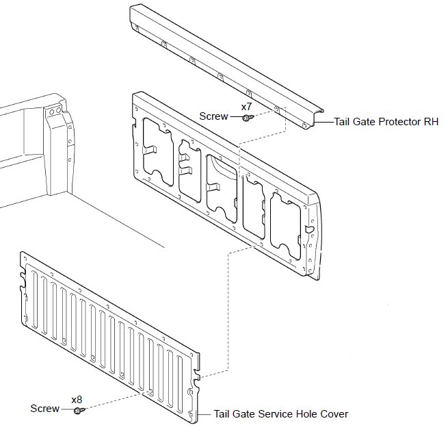

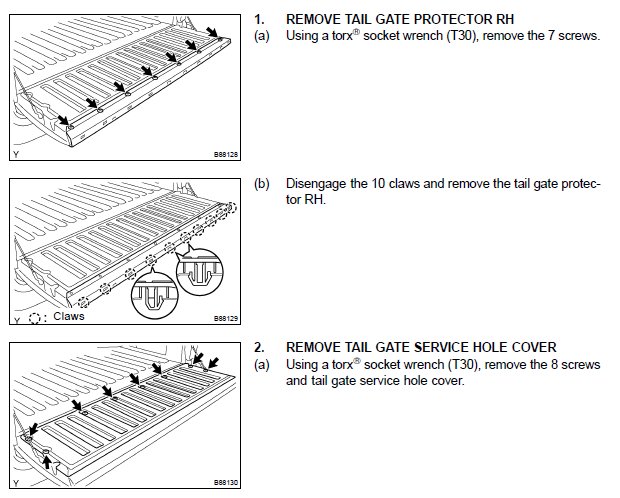

    Remove the tailgate cover and take out the tailgate camera harness and camera. Place it where you like.

    That seems relatively simple. I will give it a try

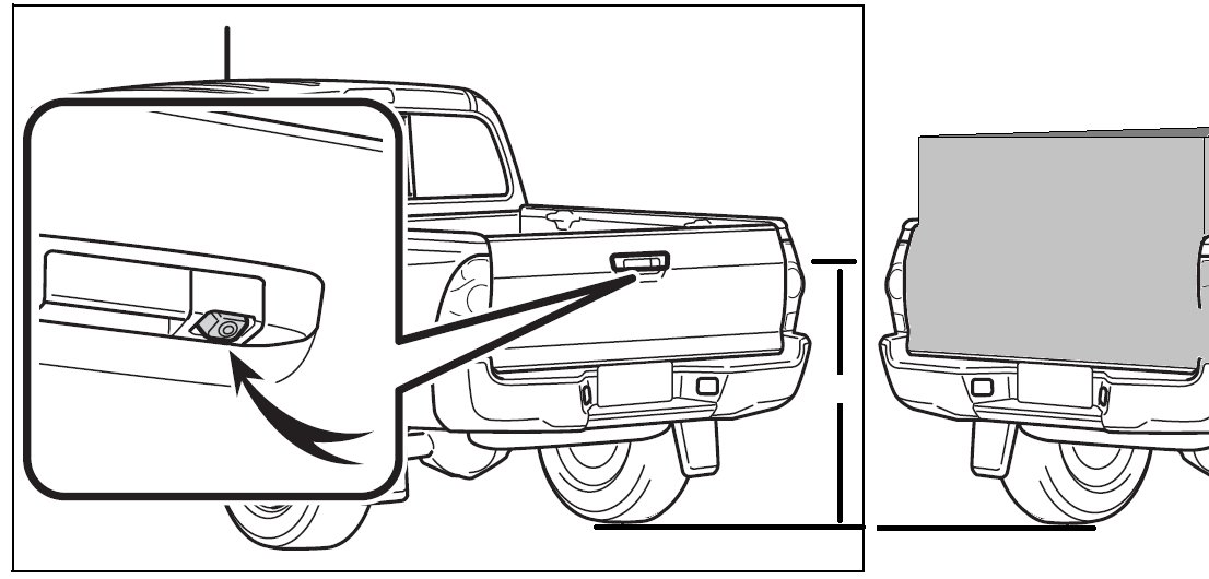

    The diagrams were great! I have it out of the tailgate and am now figuring out where to put it. There is a rectangle hole directly centered over the license plate that the camera fits through. Now I just need to figure out how to permanently attach it and keep it there (but be able to disassemble when the camper is off and I want the tailgate back on). Any suggestions? Also, having never really done this before-do I need to consider where the camera is as far as accuracy of the lines in the picture on the rearview mirror?

    I'd say buy another camera harness (82182-04012) and reattach it to the tailgate. Also, if you like, find the same height as in the tailgate for your camper, place camera there. Before camper is removed, remove connector from the underside of Tacoma and camera.

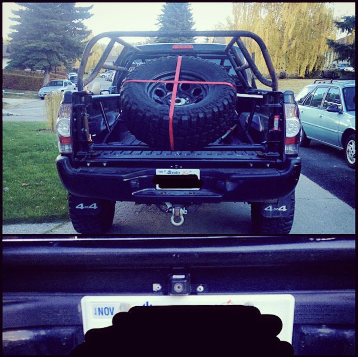

    I mounted mine in that same spot above the license plate. Used a piece of square aluminum tube and ground out the inside enough to friction fit the camera. then used a couple L brackets to rivet it in place. Allows me to move the camera back to the tailgate if I ever need to.
