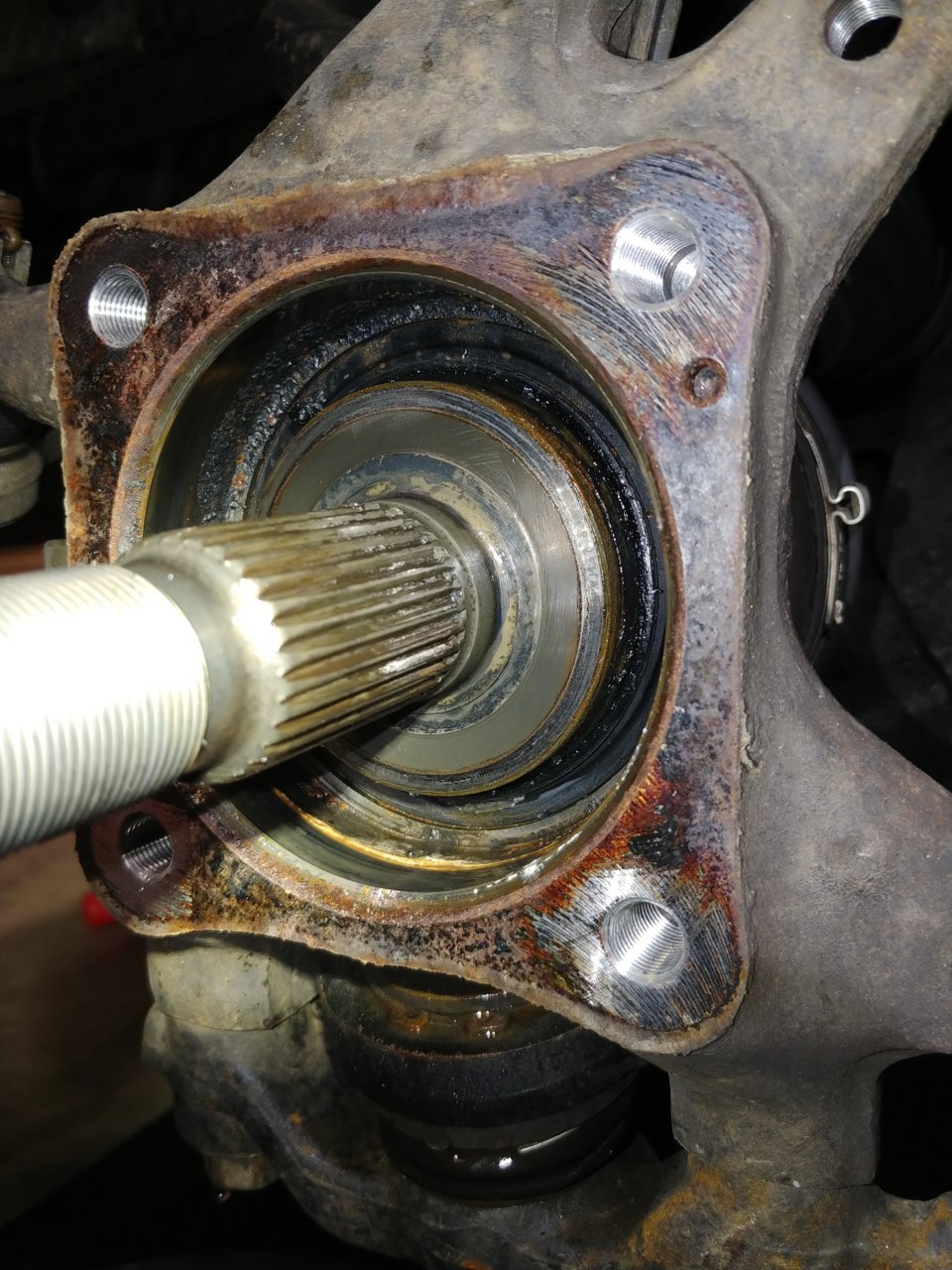

    I'm studying videos for replacing my bearing/hub assemblies.
    In this one he uses a sander to clean rust and burrs from surfaces. I'm gonna have to pick one up I guess.
    1. What sort of pads should I be using for this task? Grit size and composition?
    2. Also, anyone have recommendations on what kind of penetrant to use to help smooth removal of the bolts and various other parts? Are they all pretty equal or do some out perform others? (I have some PB Blaster, not sure if it is effective or not, haven't used it yet.)

    Just did one of mine this past weekend. Personally Im a big fan of a carbide scraper. For example:
    https://smile.amazon.com/gp/product/B07CV23377/?th=1
    You do have to be careful how you hold the tool and apply pressure, it is carbide after all and will easily cut into the metal if held up on edge at the wrong angle. Wire wheels work good too.
    The 4x hub bolts are blind holes, so penetrating oil may not help that much. Personally I didnt have any issues breaking mine loose and I live in the salt belt :(
    You will want a good 6pt (not 12pt) 17mm wrench for those bolts. Ratcheting is even better

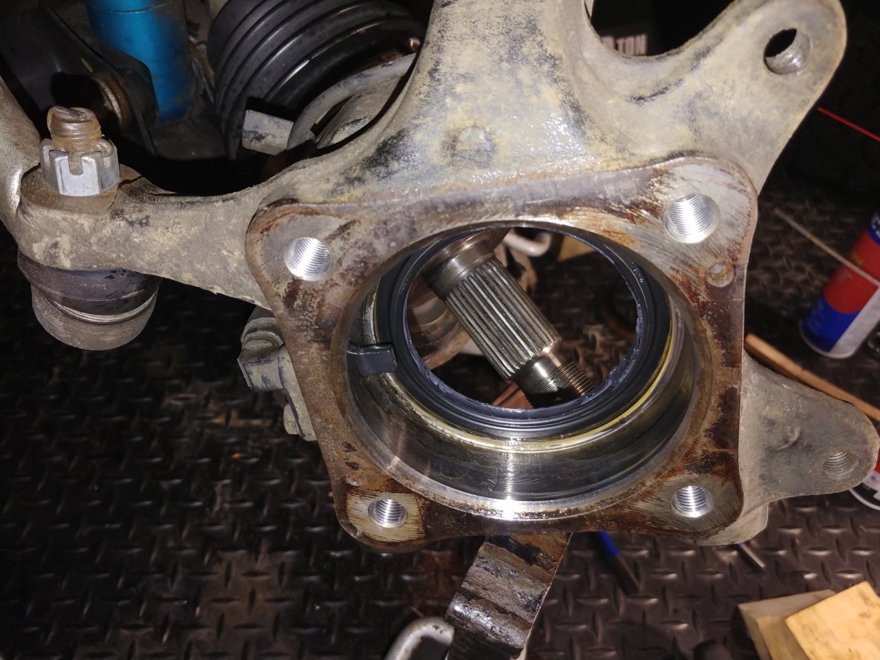

    What I do is sharpen a small chisel and tap gently around the edge, with penetrating fluid spraying lightly.
    it’s stupid but you don’t want to damage it, so slow and even is best.

    I sprayed it down with Kroil and then tapped on it with block of wood and hammer. It took a while. For me tapping on the crack with a pry bar didn’t work well.

    I used a small but 'sharp' (no burs) cold chisel. One edge flat up against the hub. Seems counter intuitive but I wasnt getting anywhere any other way and wanted to minimize damage to the cap.
    Ive used a wood chisel in the past, but wasnt getting anywhere with it this time. Found it was too narrow and sharp. Damn rust.

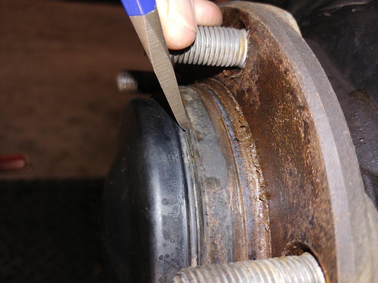

    Just buy new bearing assemblies and then a little WD40 a fine flat file and Scotch-Brite for the knuckle/spindle.

    I did mine a while back because of a bearing rumble that only corrected when I turned left...
    It was a seriously demoralizing process...I for SURE thought I was toast and then FINALLY POP...
    I had to use multiple screwdrivers AND a log splitter wedge...
    after that to pop the hub I had to put the axle nut on a few turns and hit it dead on with a sledge hammer...make sure IF you resort to this you have a spare nut in case you dent the threads like I did...
    I sanded the surface with polishing paper and then put some anti seize on.
