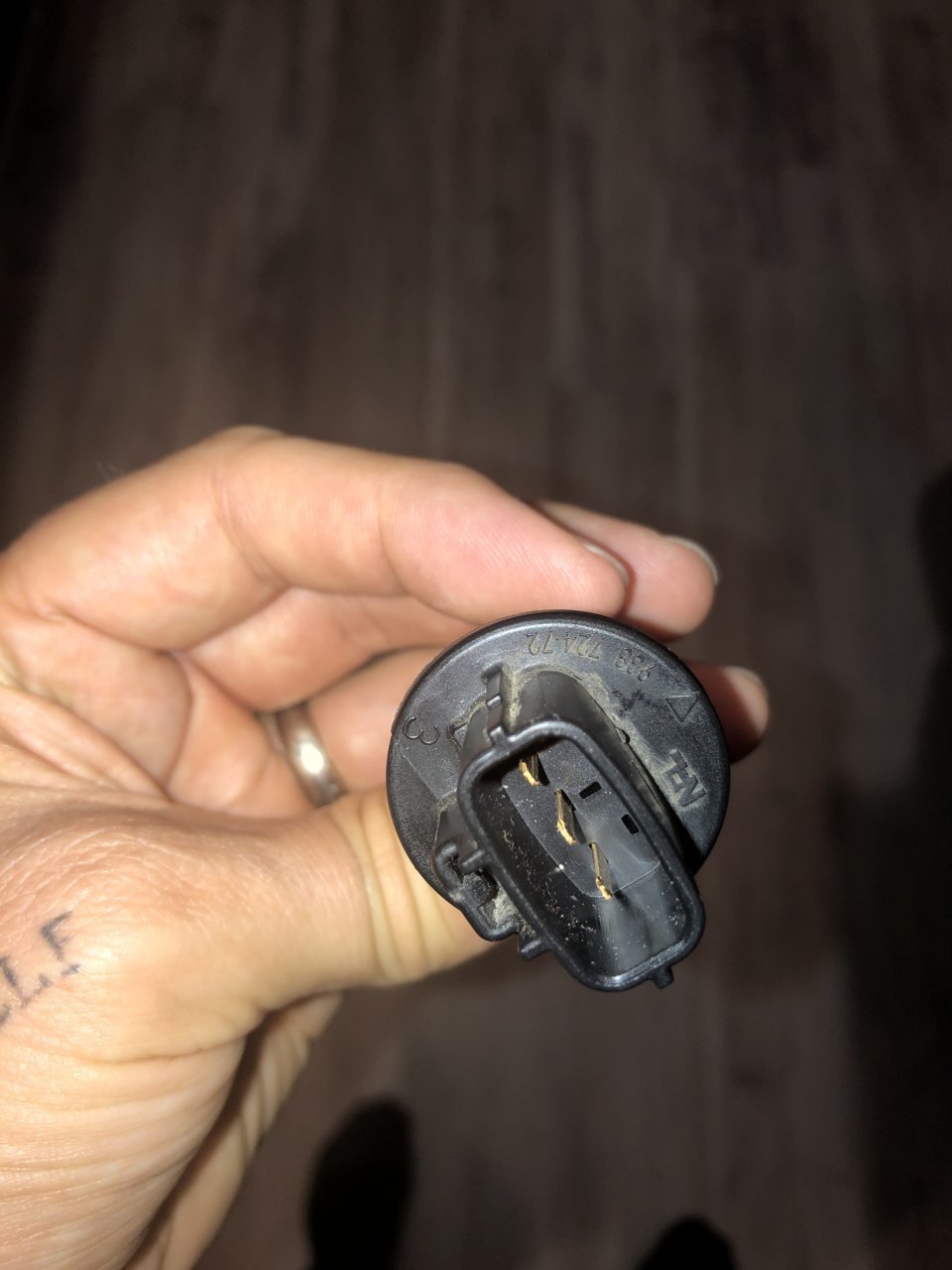

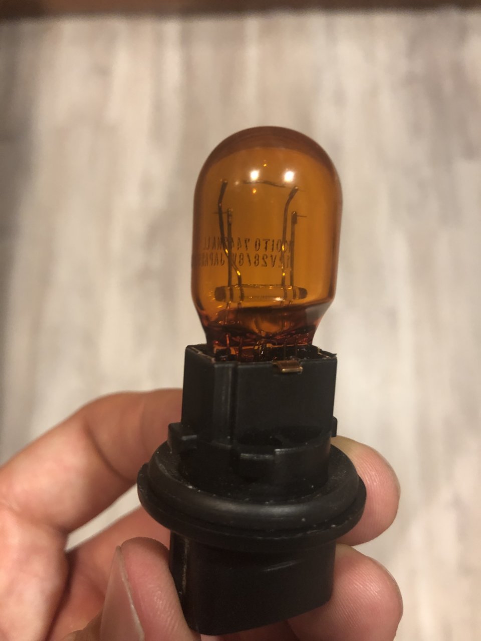

    C1E51FC5-F0D7-4B89-8795-D58CF53A692E.jpg 49CF594D-932A-49EC-B1D6-F430FAFEE9B2.jpg i have a 2016 TRD. A front blinker went out so went to change it. I cannot get the bulb out of the housing. Tried the other blinker to verify if it was just the one that was out. Both I can’t get out. Anyone else have this issue and resolved it?

    Just wiggle as you pull....

    Actually I had to break it out. A prong on the bulb was catching on the inside of the housing. Broke it out, cleaned it out, plugged new one in and boom!
