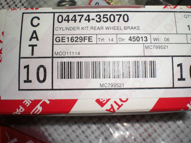

    Sir, if you don't mind what is the part # for OEM cylinder rebuild kit?

    Keep in mind ....mine is 5 lugs.
    You have to order the correct one for your year and lug #...
    Takes less than 5 min after you have it out.
