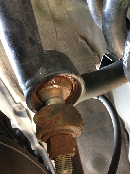

    The bottoms are just as bad. When in lube mine I do top and bottom. You don't need much but you want to make sure you have a light coat over the surface.
    I can't stress enough the importance of maintenance on uniballs. They should be replaced every year if you off-road often or about every 2 on a DD.
    Not my pic but an example of the bottom without lube.
