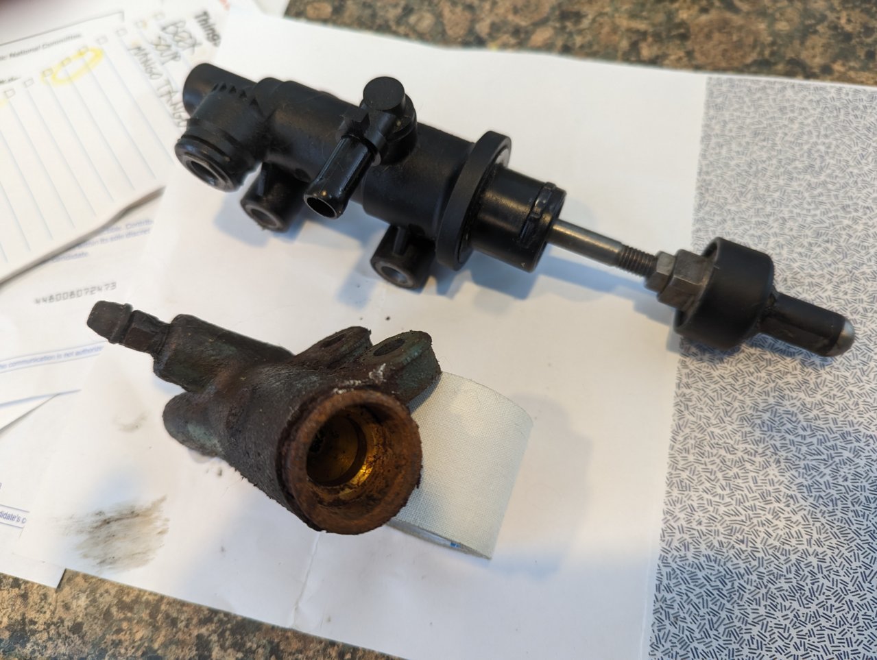

  18. Mar 21, 2023 at 2:47 AM
    #38
    DinosaurDoug_MA
    DinosaurDoug_MA Member
    Apr 19, 2018
    #251028
    19
    2006 Tacoma....first toyota:1973HiLux
    This thread seems very good (though I'm glad the off-topic electronics talk is over..?)
    What may not be obvious in diagnosis....when we think clutch might have "air in fluid" OR
    clutch pedal (motion or lack of motion!) is just STUCK all the way down but why,
    we may tend to misdiagnose.
    Hope I'm not wrong saying that "air in fluid" is mostly/always? an install-new-parts problem,
    not something that develops normally, i think, unless the fluid lines let go and leak.
    On my gen2/2006 Tacoma, mine's 4cyl 2.7...assuming/hopefully same setup on manual trans 6cyl gen2,
    yes my master cyl lives in the pedal assembly and takes fluid from the brake reservoir via rubber hose.
    I scratched my head alot while replacing a 17 yr old master and slave, when my taco developed
    the classic "pedal sticks all the way down" problem. What I think I learned:
    Spoiler: I'm saying the slave cylinder is the primary suspect...w/ dirt and rust, its piston ends up seizing/sticky/stuck.
    Confuser: the pedal assembly spring is interesting, with a spring applying different forces depending on position.
    Like any other spring setup you'd think, more travel = more spring force? Not exactly: at the bottom 1/3 or so,
    I observe the spring no longer adds MORE force. TMI/trivia? it feels odd/weak if free, but that's NOT a problem,
    it's a design feature, somehow the spring has achieved it's max-force-up with pedal halfway or 2/3 down.
    Which actually adds up to a smooth feel, since the pressure plate adds plenty of force-up around halfway down.
    My first thought when pedal stuck down: perhaps the pedal assembly needs attention,grease,something.
    I loosened the 14mm LH-side bolt-head a bit, way up high (i think RH-side nut is welded to pedal assy)
    just a half or whole turn/thread, thus loosening the bolt the pedal pivots on.
    But this accomplished nothing, the pedal wasn't bound at all by tightening, so I tightened it back and moved on.
    There's 3 or 4 things contributing to the clutch pedal's desire/ability to come back up.
    Below, I'll start "bottom up" and try to ignore the pedal assembly, which lives a sweet/rust-free life in the cab.
    Thing1: the pressure plate "fingers" I'd say exert the most force in this equation.
    The fingers, when depressed (pedal down) by the slave cyl and fork, start an obvious pushing war
    which ends, normally, when you release the pedal.
    UNLESS! Slave cyl is rusty and its piston gets jammed "engaged",
    so until/unless you crawl under and hit the fork,etc to un-stick the slave
    after trying the easier/faster "pull the pedal up" w/no luck, you may need to get towed.
    Carry a rock or hammer if you're suffering erratic stuck-pedal behavior,
    learn to crawl under and tap/hit the fork back towards the cylinder when stuck, until you SOLVE problem.
    Even this "fix" (awful temporary fix) really sucks w/danger if you got stuck at a red light in real traffic.
    already mentioned slave as likely problem, but I'm back to describing spring-back contributors.
    Thing2: slave cylinder may have an internal spring, but I forget.
    My old slave got so rusty (removed, on bench) I can't move it by hand to feel a spring fighting back.
    Then again, there's no adjustment HERE, it's self-adjusting so I'm ignoring or questioning the spring-back on slave.
    BUT THIS (slave) IS THE THING living in rusty hell, with a rubber boot that's not going to keep
    rust and dirt from messing with the slave cylinder and its piston which lives an inch inside/away from the boot.
    Thing3, the master cylinder definitely has an internal spring, so it WANTS to return fully on release.
    BUT! if things/slave is/are stuck, the fluid doesn't want to move either (won't allow master cyl to return/release.)
    That's why the pedal sticks down! But here's where I get most confused:
    Pedal seems designed to catch happily/magically to the master cylinder shaft+tip....
    (I don't know which type "tip" I have, see interesting diagrams above in this thread show types A,B,C)
    but I suspect all the tips seat and catch the pedal somewhat when installed (no strong catch, no lock nut/etc to pedal).
    I never did figure out why/how...when stuck down, pulling pedal back up ALSO seemed to pull master shaft up too.
    All I can say is, it's kind of like a tug of war with various things contributing to the release.
    Thing4, the pedal assembly has spring-back, but it seems NON-problematic once you understand its spring setup.
    You don't need to remove the assembly and I wonder if there's a 3rd and/or 4th upper bolt/nut,
    since I could only see 2 hex nuts near the bottom of the assembly. You DO have to suffer hell
    messing with the rubber hose and pinch-clamp for the fluid feed, and another hell
    re-threading the steel fluid line onto the new master. Consider not doing both, if slave is old and the problem!
    And as told in other posts on this thread, after solving any terribly-stuck problem and replacing either/any cylinder,
    check or re-do the adjustment on the master's shaft, so you will have FULLY released everything with pedal up. (Avoid allowing throwout bearing to touch pressure plate fingers)
    You should be able to hear the bearing spin up and START to touch/engage, with driver door open before driving away, as you touch the pedal in its first few inches. Crawl under and get a helper to touch pedal while you listen and watch the fork move, also!
    Shown/attached/inserted, are my original slave cylinder and master from 2006 Tacoma.
    Pardon the confusion here. Appreciate the OTHER wisdom from prior posts.
