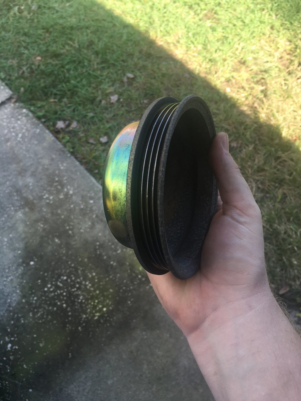

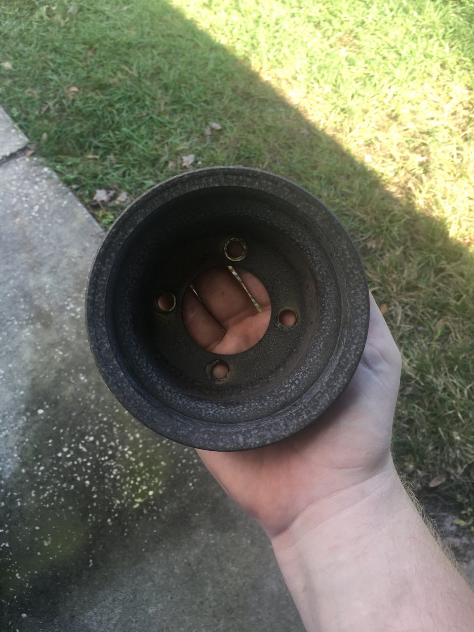

    Okay, I found the problem, i took off the pulley and found that it was completely bent at the mating surface. Been looking around for one at a salvage yard, and online, and cant seem to find them. Is there an interchangeable part from another toyota?

    Looks like this

    how many V's / grooves are there... I have left over parts from a JDM 3.4 motor swap that I did earlier this year... dont know if they will interchange or not... might have to wait until after christmas to find out.
