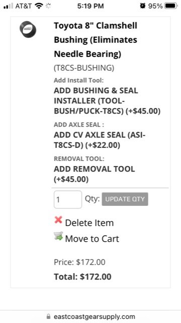

    I’m on the ECGS website now. I’m going to just pull the drivers side axle and replace the needle bearing and axle seal. Hopefully won’t have to do this twice…. lol

    Order(s) are in….
    $172 for bushing/axle seal/tool
    $40 toyota reboot kit
    the wife will certainly like hearing I spent $210 as opposed to $800+

    The tool is worth every penny.
    It seats both the bushing and seal to the correct depth.
