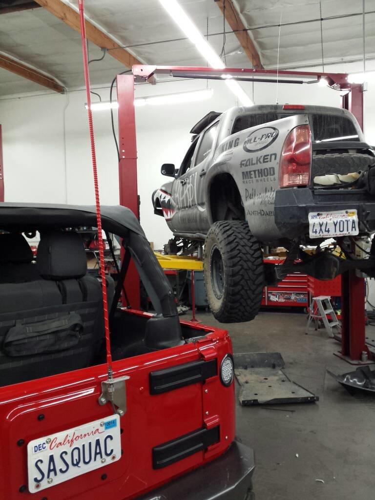

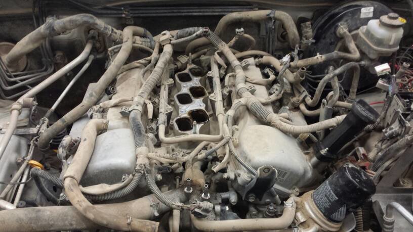

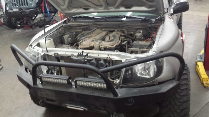

    Here's what I've got so far.

    Maybe a good steam cleaning in the engine bay :dancingbacon:

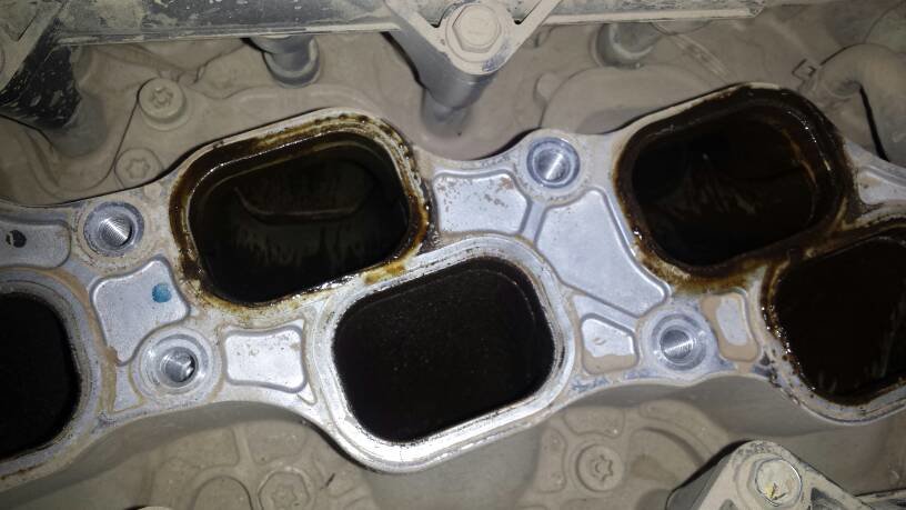

    Long story short his intake manifold somehow decided to go 7-11 Super Gulp on his oil and thus his missing 3.5 quarts with the remaining 2 in where they should be in the engine.
    Regardless, engine fuckery ensued.
