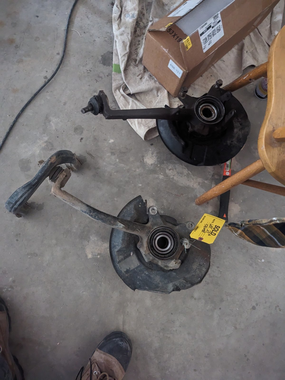

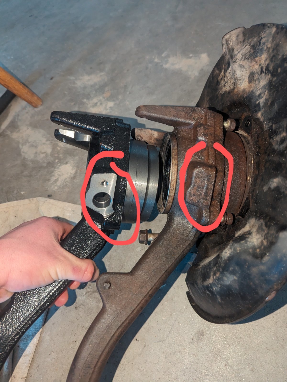

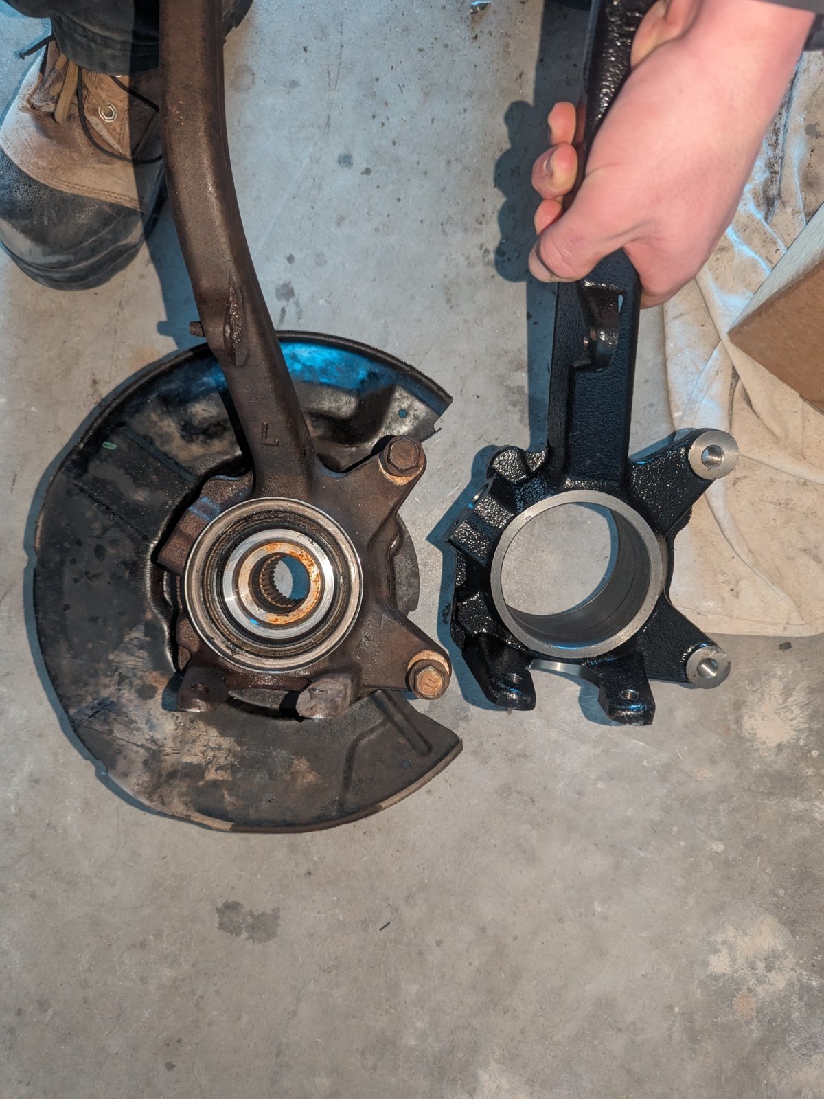

    So I need to replace my old steering knuckle and wheel bearings (broken bolt with extractor in old one) I ordered a new one through Amazon and notice the new one has the ABS sensor holes and my old one does not. Would it still be possible to seal up the new one? I still need to find a new wheel hub and bearing setup too so if you guys have any recommendations that'd be a life saver. I can always return the new one too if I find a used one with a complete setup.

    You can plug that hole up and just run the knuckle. I know I've read that on here somewhere. Not sure what you'd find that'd fit snugly in there though. Maybe just try a local scrap yard to pull an ABS sensor off a junked truck and snip the wire.
    Might get lucky and find that other Toyotas of the same era use the same ABS sensor (meaning more models you could pull a sensor from).

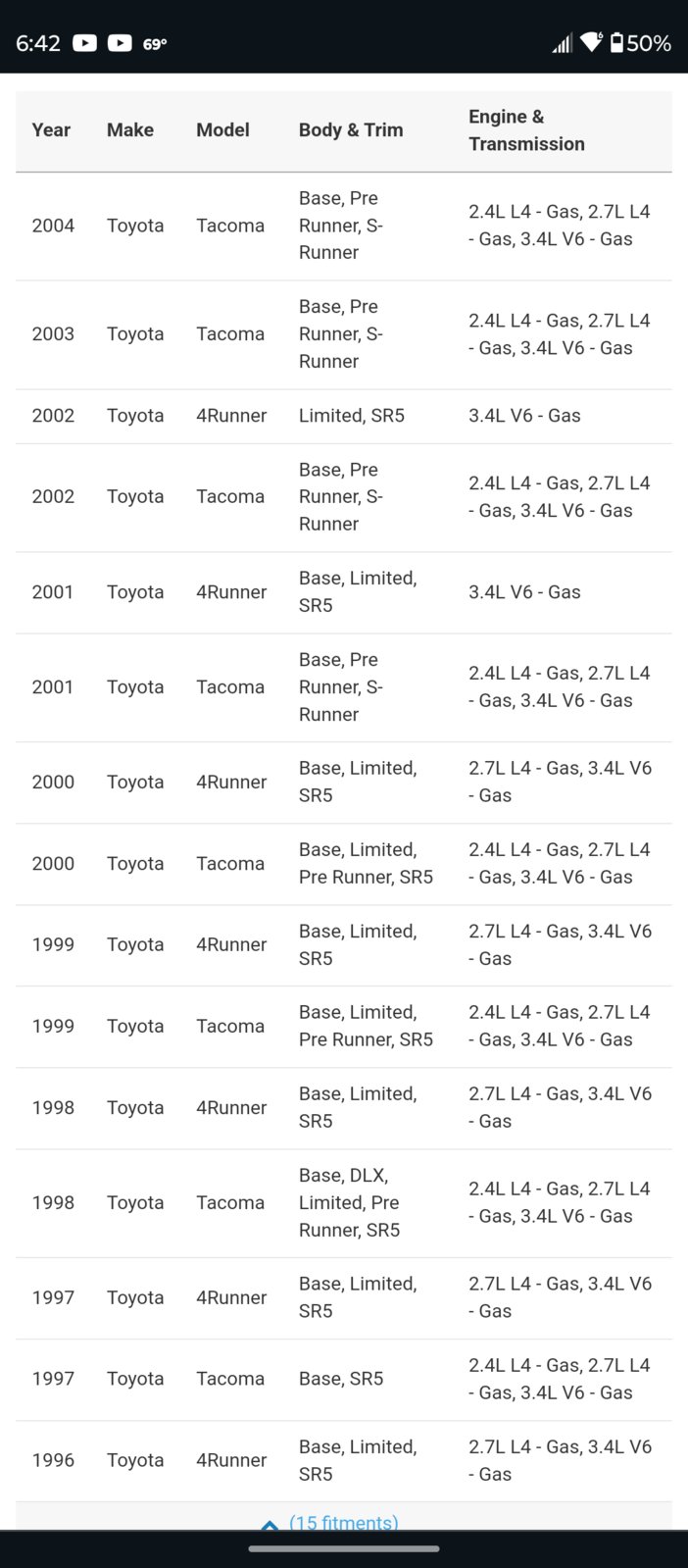

    Front Speed Sensor - Toyota (89543-35050)
    *So apparently only the Tacoma and 4runner used that speed sensor, but maybe you can get lucky and find one with ABS with the sensor intact at a pick and pull near you
    Otherwise I'm sure others will chime in with creative alternative solutions

    An auto shop here in my town was able to get me a used knuckle with wheel bearing inside of it already! $130! Took a few days but this will work perfectly

    Could probably pop a silicone plug in there
