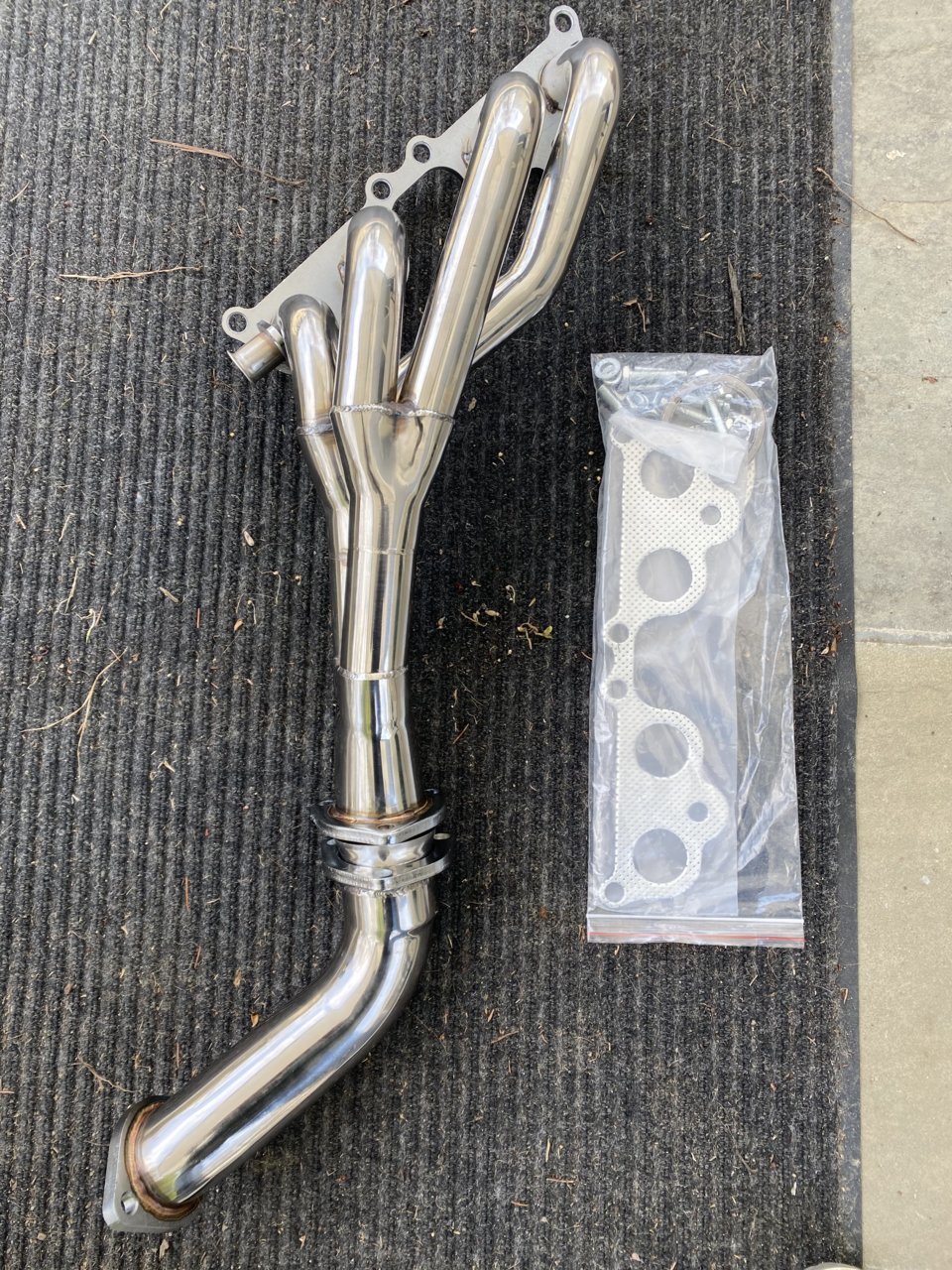

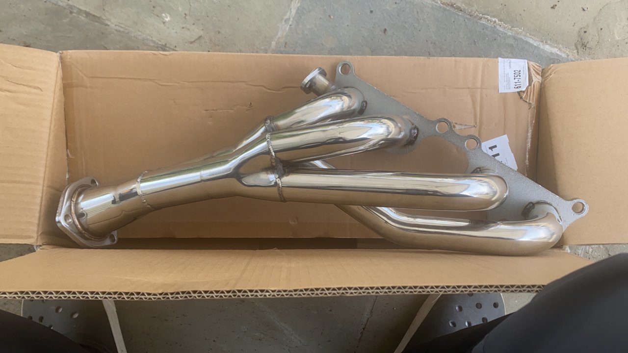

    I wanted to try these headers on my 2003 2.7L , but I heard nothing but bad news on these headers. Anyone here has used these in the past, I am in NY and will need a CARB cat that I can bolt on my exhaust as well, anyone has any ideas on where I can find them? Worst case, I will end up doing a custom stainless setup and scrap these CHINA headers.

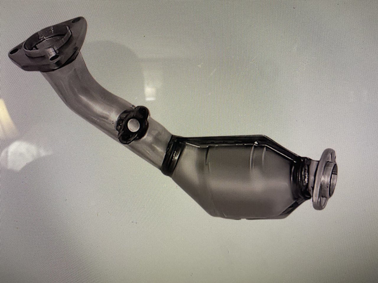

    This is the magnaflow cat , but damn! its $600 bucks!!!!!! OUCH !!!!

    I found this one for $200 , they claim
    To be CARB compliant too.!
