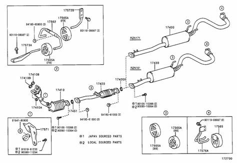

    So the Tacoma uses two cats, according to the image. Is this what they consider bank 1 & bank 2 ????

    Bank 1 and Bank 2 refer to driver side and passenger side. But I don't remember which bank is which side.

    When you look at any V motor there is one cylider head that is farther forward than the other, this is always bank 1. On an inline 6 cylinder motor the first 3 cyliders are bank 1. On a 4 cylinder motor there is only bank one, I am sure that there is going to be some obscure manufactuere that will make a liar out of me on this.
