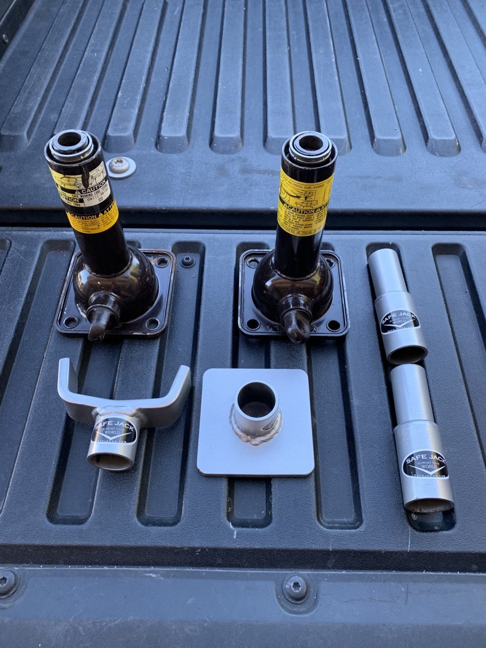

    0531CE89-F64B-499A-999E-1F5A2368D301.jpg Taking a cue from @DVexile
    It's coming together.
