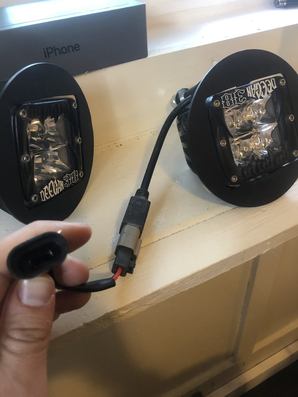

    I recently got these Rigid LED pods and also ordered the Cali Raised LED pod fog light mounts. I ordered the wiring adapters as well so it would be plug and play, I go to install them and they won’t turn on! Checked all plugs, and nothing. Am I missing something?

    LED's are Polarity Sensitive.
    Is there any way that you can get the (+) and (-) backwards?

    I thought the same thing but they only can plug in one way.

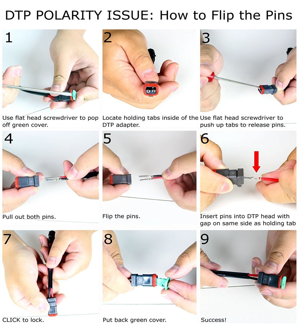

    Get your OEM Adaptors and try this.

    Thank you! I will try that

    When I did it originally on my 2nd gen that was the problem for me!

    This fixed my problem, thank you !
