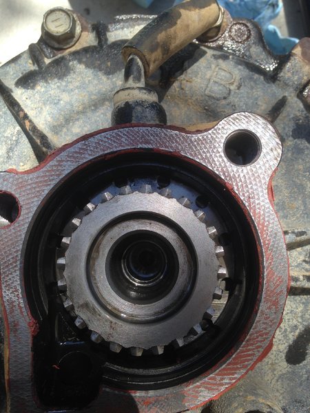

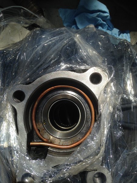

  14. Jun 4, 2016 at 11:02 AM
    shawnMc
    shawnMc Well-Known Member
    Sep 25, 2015
    #165143
    237
    Shawn
    Santa Barbara
    2009 Tacoma regular cab 4x4
    How do I get this gear out of my old clamshell and into my new one?
  15. Jun 4, 2016 at 12:25 PM
    shawnMc
    Sep 25, 2015
    #165143
    237
    Shawn
    Santa Barbara
    Never mind, I figured it out. Two pry bars popped it out.
