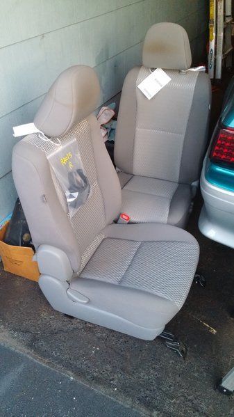

    Hopefully these will replace the bench on my truck this coming Saturday..0325161915.jpg

    Just replaced my bench in an 05 reg cab with sport seats couple mo ago. Pretty straight forward - lots of help on this site. very happy with the result.
